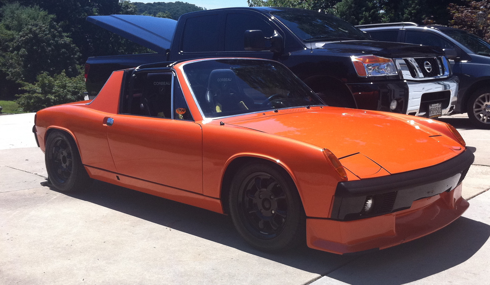

I did not even know what a valve cover was when I bought this car about 2 years ago. (IMG:style_emoticons/default/biggrin.gif) The PO was a little worried about selling the car to me because he could tell I was totally clueless. I am really enjoying working on the car, but with the weather improving I am getting anxious to drive the car again. Here is a shot of the car.

Nice car. What color is that? Nepal orange, Signal orange or Phoenix Red?
