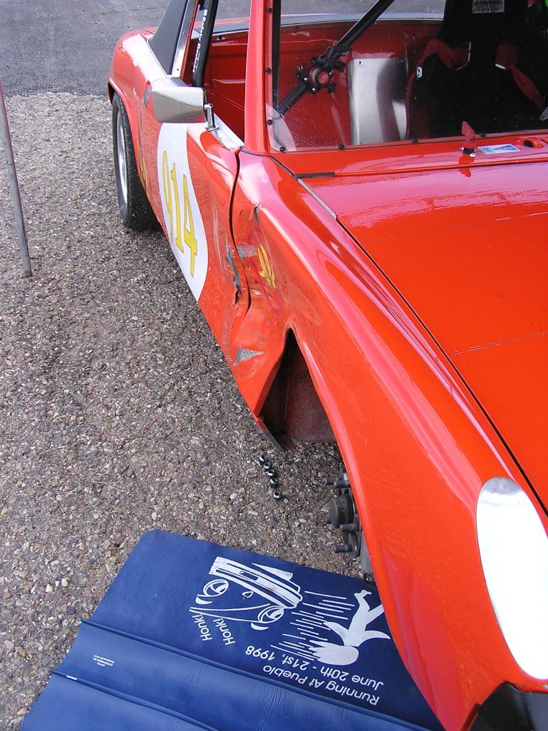

I've been hit 3 times now.. not a fun thing at all
the worst was by a stupid miata that took out my front fender, front suspension, door, and rear fender all at once.
