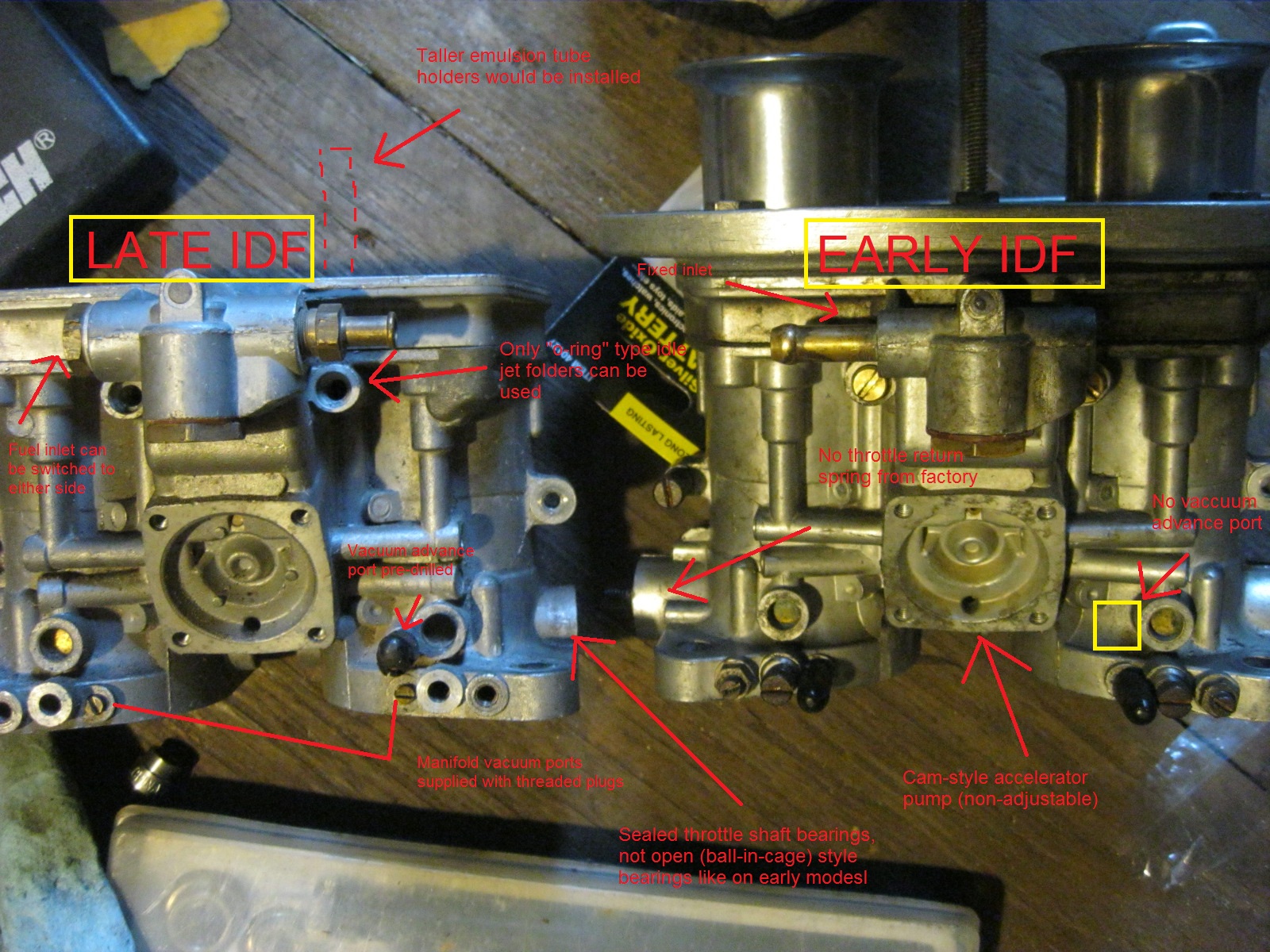

Below is a picture of an early and late set of Weber 40 IDFs.
Some of the characteristics of EARLY versions are:
-Short emulsion tube holders
-Short throttle shafts with little overhang outside of the carb body
-Non-sealed, ball-in-cage style throttle shaft bearings
-Cam-actuated, non-adjustable accelerator pump assembly
-No ports for "ported" vacuum (still has 2 "manifold" vacuum ports)
-76 degree bevel throttle plates (this may or may not hold true for every set of early carbs)
-No throttle return springs installed from factory (thanks Kevin for clarification)
-Most (all?) were made in Italy and are stamped as such
Later style Weber 40 IDFs (Weber 40 XEs) are usually characterized by:
-Taller emulsion tube holders which extend above the carb top
-Longer throttle shafts
-Sealed black throttle shaft bearings
-Adjustable, spring cushioned accelerator pump assembly
-One pre-drilled ported vacuum port in addition to two threaded manifold vacuum ports
-78 degree bevel throttle plates
-Factory installed throttle return springs
-Made in Spain, but potentially also Italy and Brazil
