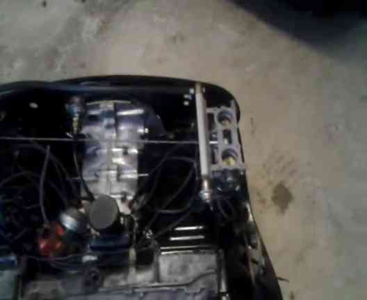

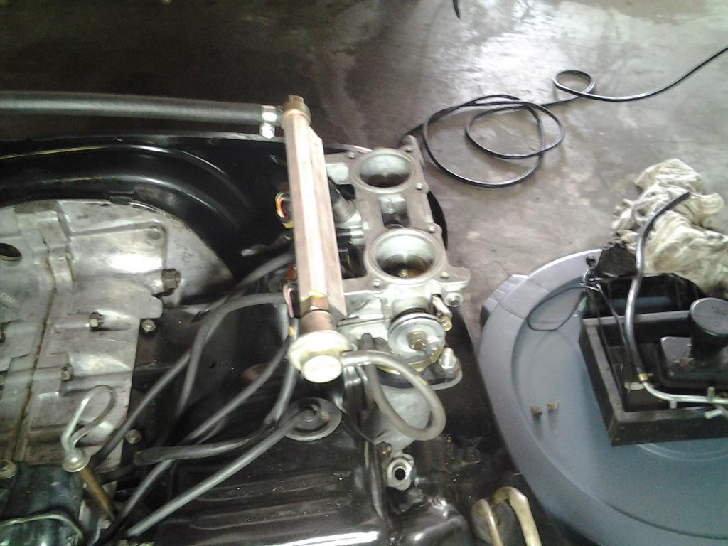

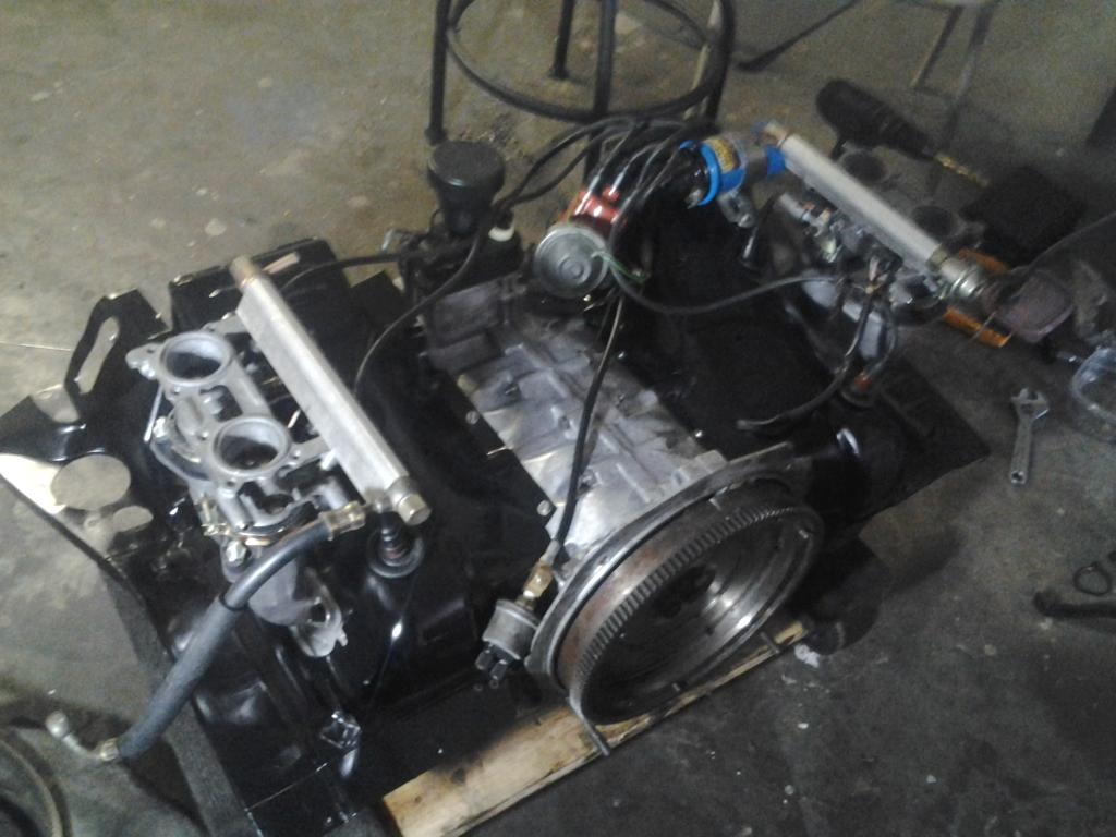

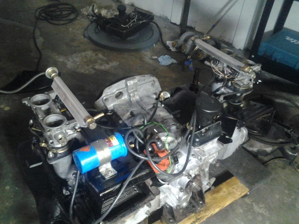

I have them mounted to the engine, started running some of the vacuum lines and fuel lines and built a linkage.
Here are some pics and a quick vid of the linkage. Sorry about the quality all I had with me was my phone.
The bottom pic is a link to the video, if that doesn't work there is a direct link below it.
Let me know what you think!
(IMG:http://www.914world.com/bbs2/uploads_offsite/i694.photobucket.com-11752-1365611116.1.jpg)
(IMG:http://www.914world.com/bbs2/uploads_offsite/i694.photobucket.com-11752-1365611117.2.jpg)
(IMG:http://www.914world.com/bbs2/uploads_offsite/i694.photobucket.com-11752-1365611117.3.jpg)
(IMG:http://www.914world.com/bbs2/uploads_offsite/i694.photobucket.com-11752-1365611117.4.jpg)
http://s694.photobucket.com/user/Kevin3118...0779db.mp4.html
The linkage is just a length of 10-32 threaded rod with heim joints and a pair of 1/8" nylon bushings between the heim and the throttle shaft arm.
