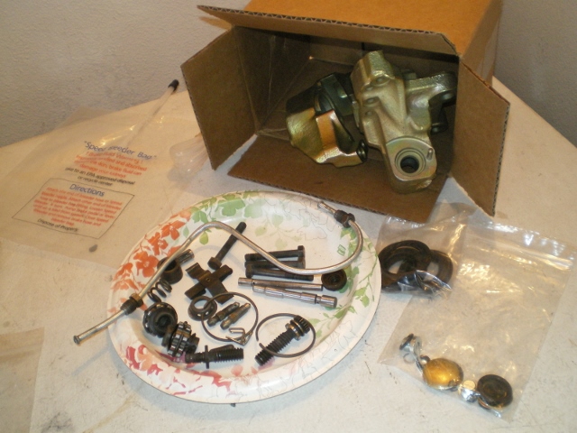

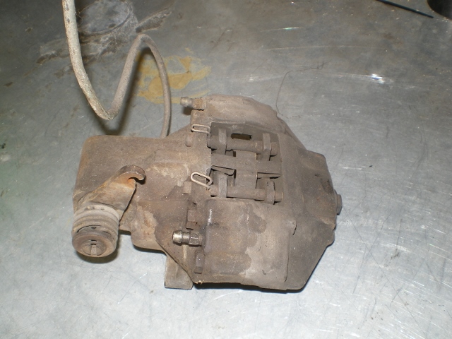

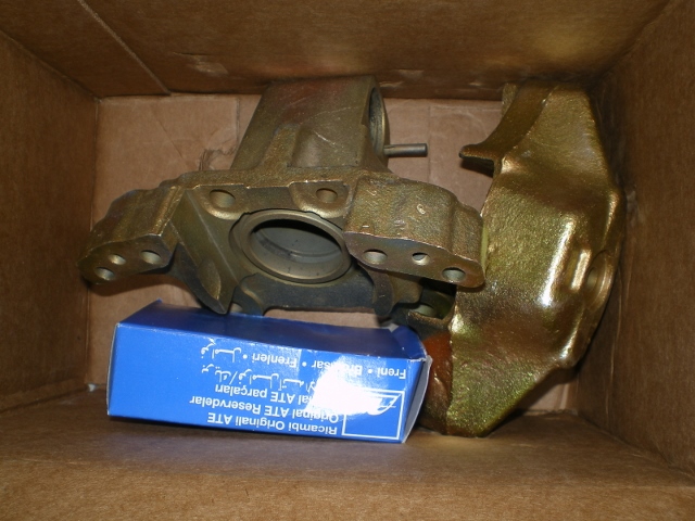

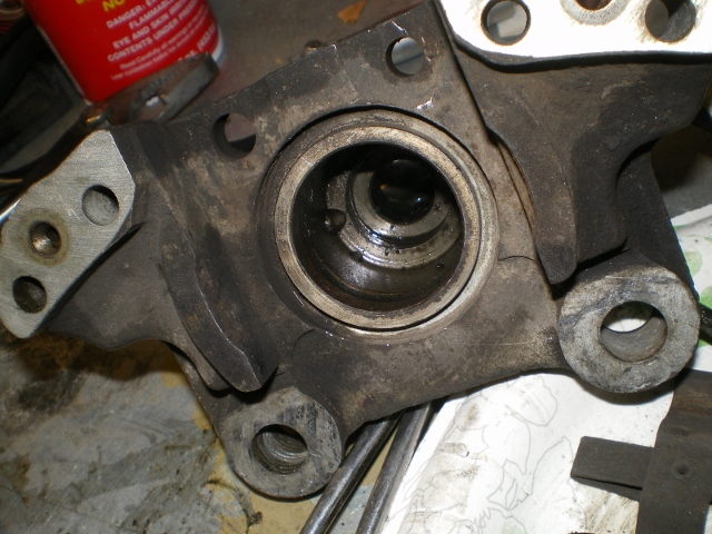

I haven't posted here for a few days and thought that I had better get busy. If I'm doing the suspension I may as well do the brakes. I had previously done the fronts and now is the time for the rears. Check out Old Crusty. Not the Cap't., the caliper.....

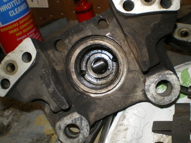

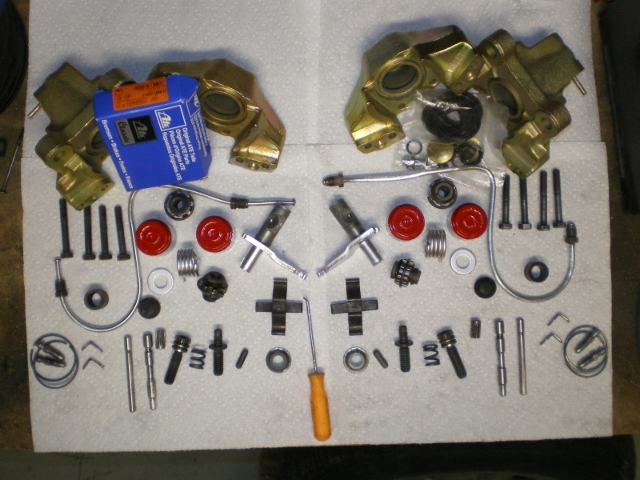

So after dis assembly I'm left with this mess.....

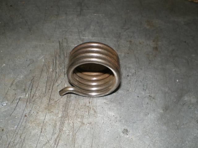

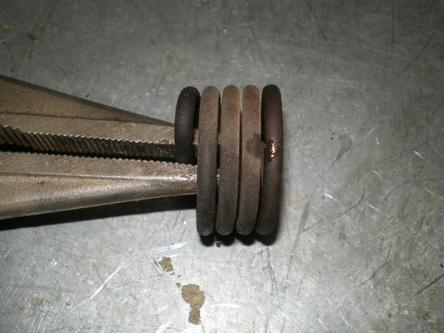

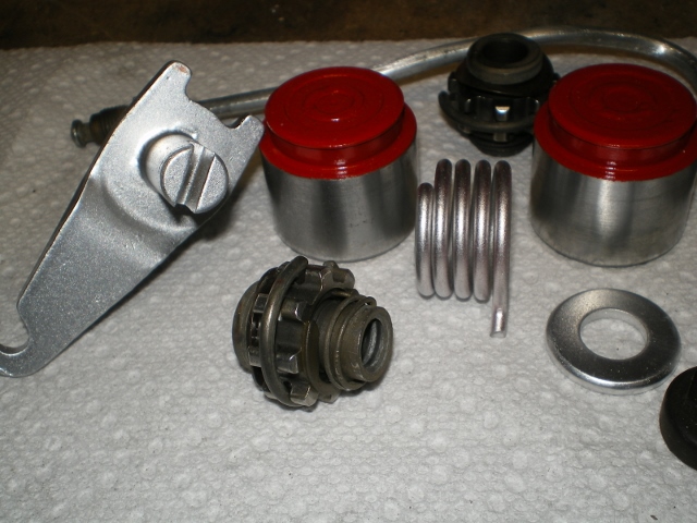

one dirty Ebrake return spring......

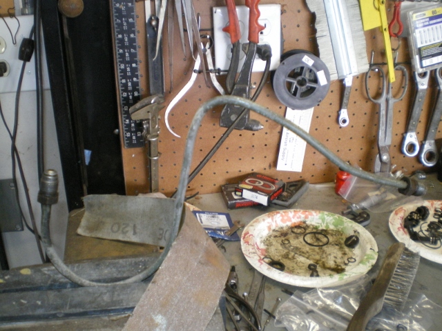

one clean spring, BTW, I cleaned this spring in < 2 min's (and many other brake parts) with a $5 3/4" copper fitting brush which I sawed the wooden handle off of and then chucked it into my bench top drill press.

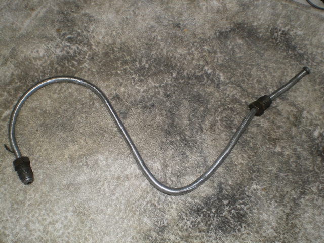

the brake lines were held with rubber jaws in the vise while I cleaned them with some sand cloth.
5 min's later
some Shea stuff

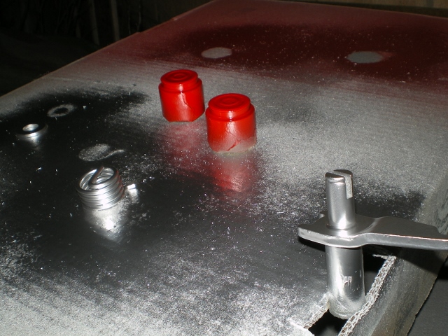

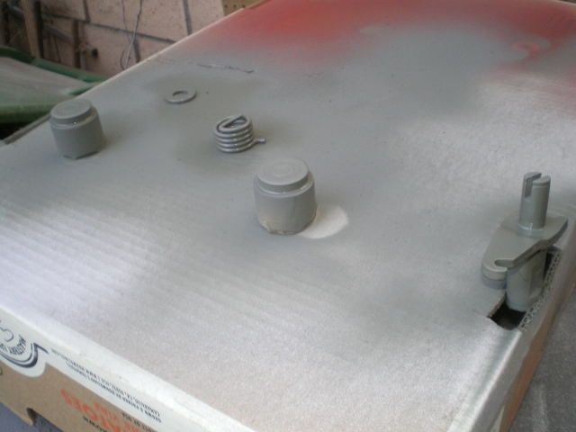

a little dab of self etching primer after parts are cleaned
a little paint. the red is a VHT caliper paint whilst the silver is.......well it's silver
some shiny parts

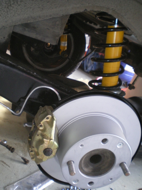

and one dress rehearsal before final assembly
and in place
