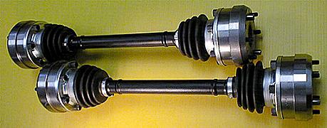

If you have the 911 hubs that you can use the shorter 911 axles, IIRC. If you have the original hubs then you can use stronger, shorter bus type axles.
For idas check out this link to an axle upgrade:
http://www.pelicanparts.com/catalog/shopca..._pg4.htm#item22
You could likely have these adaptors made thinner as these were made to take up the length difference as well.

Mueller   Here you go: SmartRacing Products, custom axles ...   Jul 4 2004, 02:37 PM
Mueller   oh yea, where are you located? I'd like to see...   Jul 4 2004, 02:38 PM
