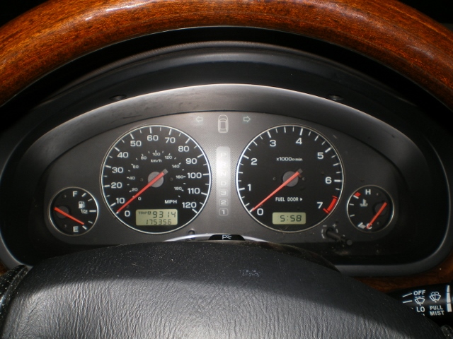

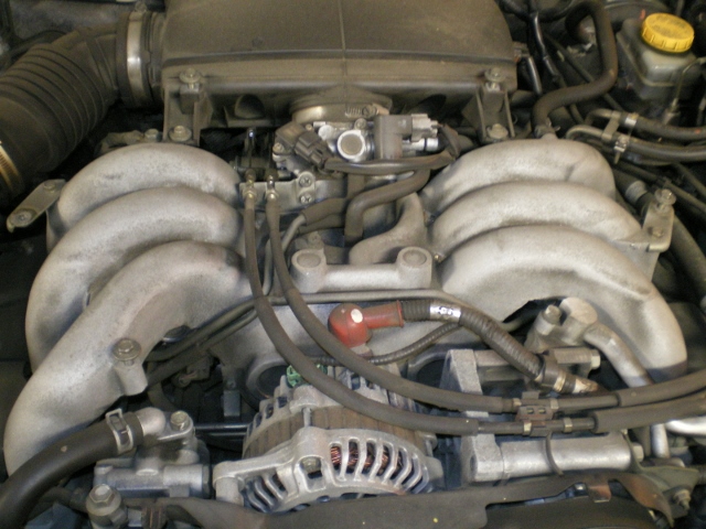

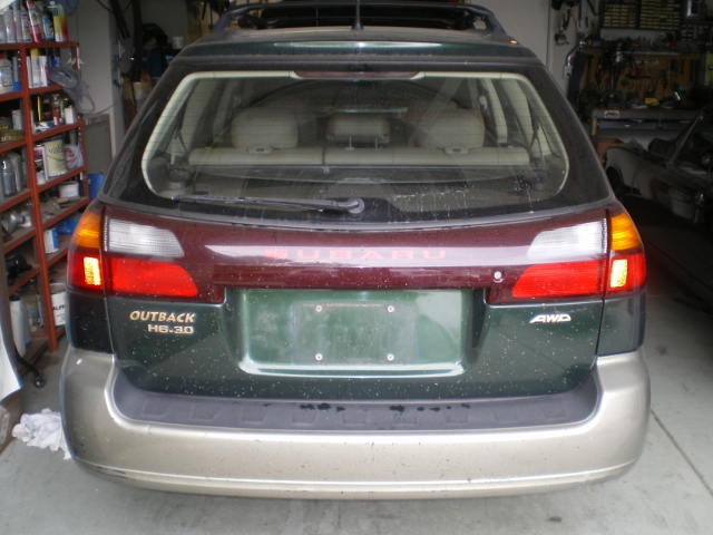

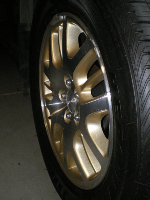

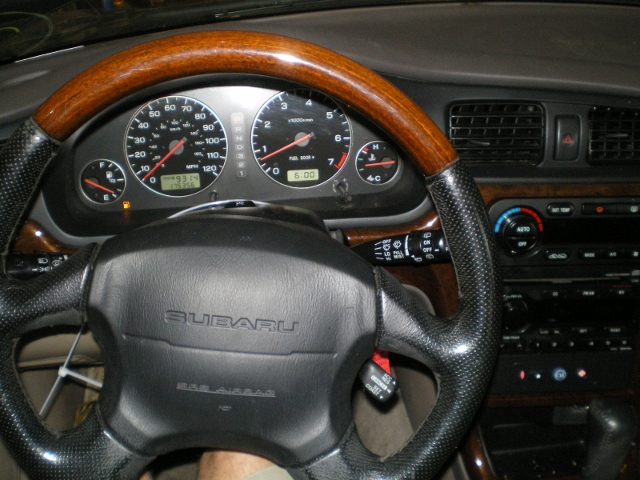

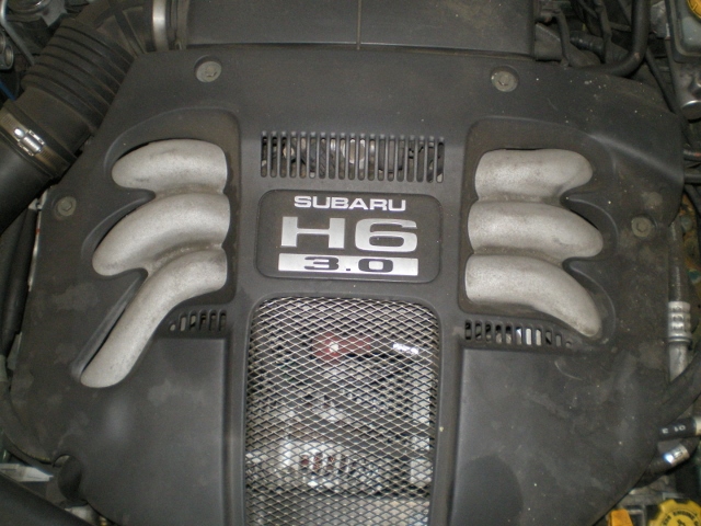

Look what landed in my garage yesterday. Couldn't believe it happened so fast. Let me back up. 22 March I joined CoParts with the 30 day free trial membership. The Copart site lets people like you and me buy cars through an agent (ING in my case). There is a fee for this (300-400) and you must put up $400 min deposit. If you want to place a bid of more than $4000 then you would need to pony up some more. They have a "buy it now" feature which I used on 19 April. I know I paid a bit more rather than bidding on it but I only had 3 days left on my membership and would have had to pony up for an annual membership had I not purchased by the 22nd so I rationalized this as a wash. (IMG:style_emoticons/default/biggrin.gif). Once they received the wire transfer I was allowed to have the car picked up. So 1030 hr's Monday I put in a request for transport bids which come quickly. I received quotes from $1250 (guaranteed delivery within 2 days) to $350. I called the 350 quote and held his feet in the fire until he said that it would be picked up this week. I gave them $100 over the phone and was told to give $250 cash to the driver upon arrival. OK. 45 min's later I receive a call from the driver wanting the lot number. He was there and headed my way. 26 hours and $350 after my first call to the transport company it was in my driveway. Kudos to Brad at Lightning Auto Carriers (Boca Raton, FL) for being a man of his word.

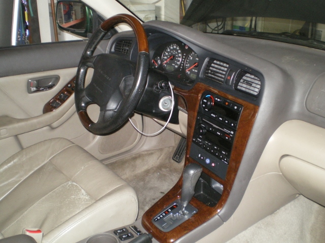

Shit, this is a nice car and I'm trying not to get attached to it. Especially since it's my favorite color; green! Everything works except the drivers side mirror. The check engine light is on so I started it and let it idle for about 40 min's to check for overheating and/or fluid leaks. No problems. (IMG:style_emoticons/default/biggrin.gif) So far. (IMG:style_emoticons/default/dry.gif) All the fluids are topped off and "clean". Even the oil and air filter are clean. Good sign that the PO took care of her. Great tires but they are 16". She idles smoothly and shifts well so the tranny will bring some $$. HF has the OBDII scanner for $49 this week so I think I will see why that "check engine" lite is on before the transplant. I won't know what to believe once it's transplanted and I'm up to my neck in error codes. (IMG:style_emoticons/default/sad.gif) So w/o further adieu meet Greenie:
Hoping to add this wheel and steering column, too. And I believe those gages should graft in as well.
Nice wheelsAttached Image
with lots of thread
But this, more than any other reason, is why I wanted this car.
Topless
I know Chris will outrun me with his 3.3 but it's what I wanted. Unfortunately, I cannot begin stripping her until after 23 May because I have tons of family coming for my daughters graduation. She's getting her masters and the truth be told; that means the world to me. (IMG:style_emoticons/default/smile.gif)
