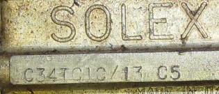

Seems that this year I need to put a little gas into the carb to get the car started initially. I have single Solex carb that no one seems to be able to identify. I'm sure some PO just pulled it off something that was sitting in a junkyard. Once I get car started and it warms up it idles OK but runs rough when you try to drive it. Timing is spot on. Recent (not too many miles ago) tune up with the help of some very knowledgeable 914world brethren. Let’s say it’s a given that there is nothing wrong with the engine. I have an idea of where to go next. I’ve had car for about 7 years. With only what I’ve told you here what’s your opinion?
