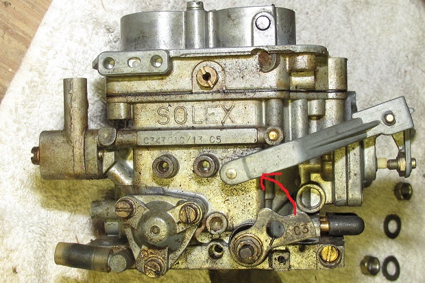

Seems that this year I need to put a little gas into the carb to get the car started initially. I have single Solex carb that no one seems to be able to identify. I'm sure some PO just pulled it off something that was sitting in a junkyard. Once I get car started and it warms up it idles OK but runs rough when you try to drive it. Timing is spot on. Recent (not too many miles ago) tune up with the help of some very knowledgeable 914world brethren. Let’s say it’s a given that there is nothing wrong with the engine. I have an idea of where to go next. I’ve had car for about 7 years. With only what I’ve told you here what’s your opinion?

At what point should this cam bracket actuate the accel pump? This is the at rest position with the butterfly closed. You have to push the peddle a long way before cam shaped bracket even touches the accel pump. By the time this happens both butterflies are wide open. Seems like it should happen before that. Should it be touching the accel pump actuator arm at rest so it sprays extra gas as soon as you touch the peddle at all? Attached Image

angerosa   At what point should this cam bracket actuate the ...   Apr 29 2013, 09:01 PM
ThePaintedMan   Assuming it works like every other carb (and physi...   Apr 29 2013, 09:19 PM
angerosa   Assuming it works like every other carb (and phys...   Apr 30 2013, 10:45 AM
ThePaintedMan   So just to confirm... The "at rest" pos...   Apr 30 2013, 10:55 AM
angerosa   So just to confirm... The "at rest" po...   Apr 30 2013, 11:06 AM
kg6dxn   That's a big gap between the cam and pump arm....   Apr 29 2013, 10:18 PM
ThePaintedMan   That's a big gap between the cam and pump arm...   Apr 29 2013, 10:22 PM
angerosa   That's a big gap between the cam and pump ar...   Apr 30 2013, 10:51 AM
angerosa   That's a big gap between the cam and pump arm...   Apr 30 2013, 10:49 AM
kg6dxn   Looks like the arm needs to come way down. Where i...   Apr 29 2013, 10:42 PM
ThePaintedMan   Looks like the arm needs to come way down. Where ...   Apr 29 2013, 10:46 PM
kg6dxn   Looks like the arm needs to come way down. Where...   Apr 29 2013, 11:08 PM
