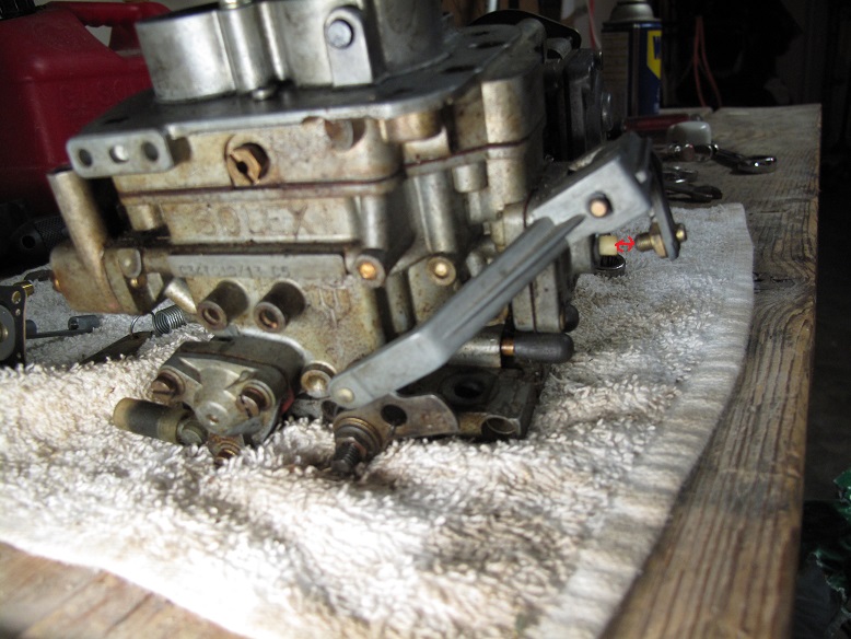

So everyone is pointing out this distance that just shouldn't be here. Looks like it's been like this for a while. I found two other Accelerator pumps in a bag of old stuff from the PO. Both were used and looked exactly the same as the one that's in the carb.
So we all agree this gap is too big. The only adjustment is the fine adjustment screw you see in the picture and it can't be screwed in anymore than it already is. Obviously the person who last rebuilt the carb turned the screw in as far as it can go. Nothing is broken or bent.
I also took a good look at the carb tonight turning the throttle and watching how the cam interacted with the accelerator pump actuating arm at different points. There's actually two lobes, first lobe sprays more when engaging the primary and the second lobe sprays when the secondary is engaged.
So I can think of only two other logical conclusions.
1. The pump is so torn that the button is pushed in farther than it should be.
or
2. The answer I'm hoping is the silver bullet I've been looking for.
Anyone?

angerosa   At what point should this cam bracket actuate the ...   Apr 29 2013, 09:01 PM
ThePaintedMan   Assuming it works like every other carb (and physi...   Apr 29 2013, 09:19 PM
angerosa   Assuming it works like every other carb (and phys...   Apr 30 2013, 10:45 AM
ThePaintedMan   So just to confirm... The "at rest" pos...   Apr 30 2013, 10:55 AM
angerosa   So just to confirm... The "at rest" po...   Apr 30 2013, 11:06 AM
kg6dxn   That's a big gap between the cam and pump arm....   Apr 29 2013, 10:18 PM
ThePaintedMan   That's a big gap between the cam and pump arm...   Apr 29 2013, 10:22 PM
angerosa   That's a big gap between the cam and pump ar...   Apr 30 2013, 10:51 AM
angerosa   That's a big gap between the cam and pump arm...   Apr 30 2013, 10:49 AM
kg6dxn   Looks like the arm needs to come way down. Where i...   Apr 29 2013, 10:42 PM
ThePaintedMan   Looks like the arm needs to come way down. Where ...   Apr 29 2013, 10:46 PM
kg6dxn   Looks like the arm needs to come way down. Where...   Apr 29 2013, 11:08 PM

angerosa   Just got off the phone with the carb rebuild kit s...   Apr 30 2013, 03:34 PM
angerosa   So everyone is pointing out this distance that jus...   Apr 30 2013, 08:13 PM
DBCooper   Take off the screws holding in the accelerator pum...   Apr 30 2013, 10:12 PM
ThePaintedMan   Take off the screws holding in the accelerator pu...   May 1 2013, 09:23 AM
angerosa   I will get the accel pump out but can't do it ...   May 1 2013, 11:11 AM
angerosa   latest news. I got the carb kit and what I thought...   May 4 2013, 09:30 AM
angerosa   The story picks up here... So last you knew I was...   May 4 2013, 04:13 PM
kg6dxn   Now you're at the point where you find the ach...   May 4 2013, 04:49 PM
angerosa   Thanks Mike - makes a lot of sense. There is a str...   May 5 2013, 06:33 PM
ThePaintedMan   I agree with what Mike is saying. The longer intak...   May 6 2013, 08:24 AM
