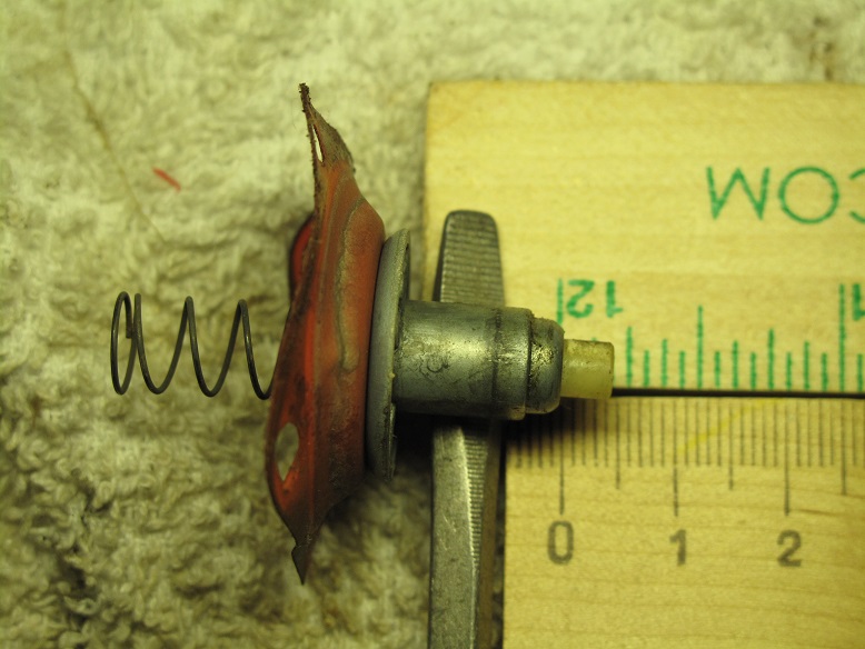

At about 8 this morning I went outside and started giving the carb a gasoline bath. I wanted to put the same accel pump back in because it looked to be in good condition. The spring also looked to be just fine.

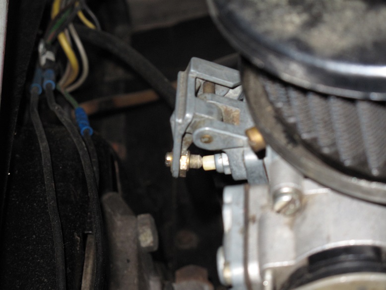

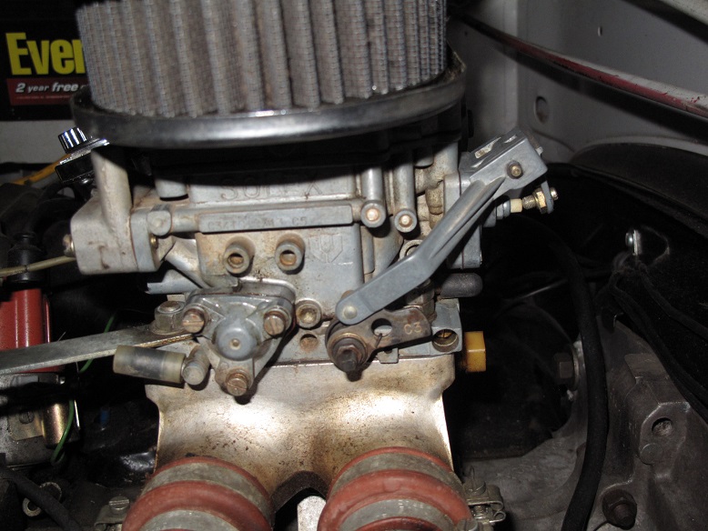

I wanted to just clean out the inside of the accelerator pump reservoir because it looked a little dirty. I was hoping I could find some other adjustment to get the cam closer to the accel pump actuating arm. When I got everything back together it lined up perfectly! It was just some gummed-up grime that was holding the button in and the gasoline bath had cleared it out. I mounted the carb back on the intake and made some small adjustments to the fine adjustment screw in the actuating arm so that the accelerator pump is actuated with the smallest push of the peddle. I also put the tension spring on a little tighter. I had an issue where my carpet was keeping the peddle from fully returning to the neutral position which made the car idle a bit higher when that happened. Now it doesn't do that. Here's what it looks like now.

My car runs 95% better but I still don't know how to tune this thing. When I got everything back on my car I still had an issue where it was dying out when I hit the throttle. I found that if I tuned the screw for Primary idle jet a tiny bit, it got rid of that. See earlier in my thread the diagram of my carb that kg6dxn posted...
Should I be turning that screw?
What knobs should I be tweaking to tune this carb?
What jets should I be adjusting if any?
The only symptom I have now that I would try to get rid of is that when I'm in the wrong gear, the car bucks and backfires a little bit. For example if I'm in 3rd going slowly up a hill and I nail the throttle, the car bucks instead of slowly accelerates to speed like I would expect a FI car to behave. This is not really a huge problem but I bet with the right adjustments I could get rid of it.
