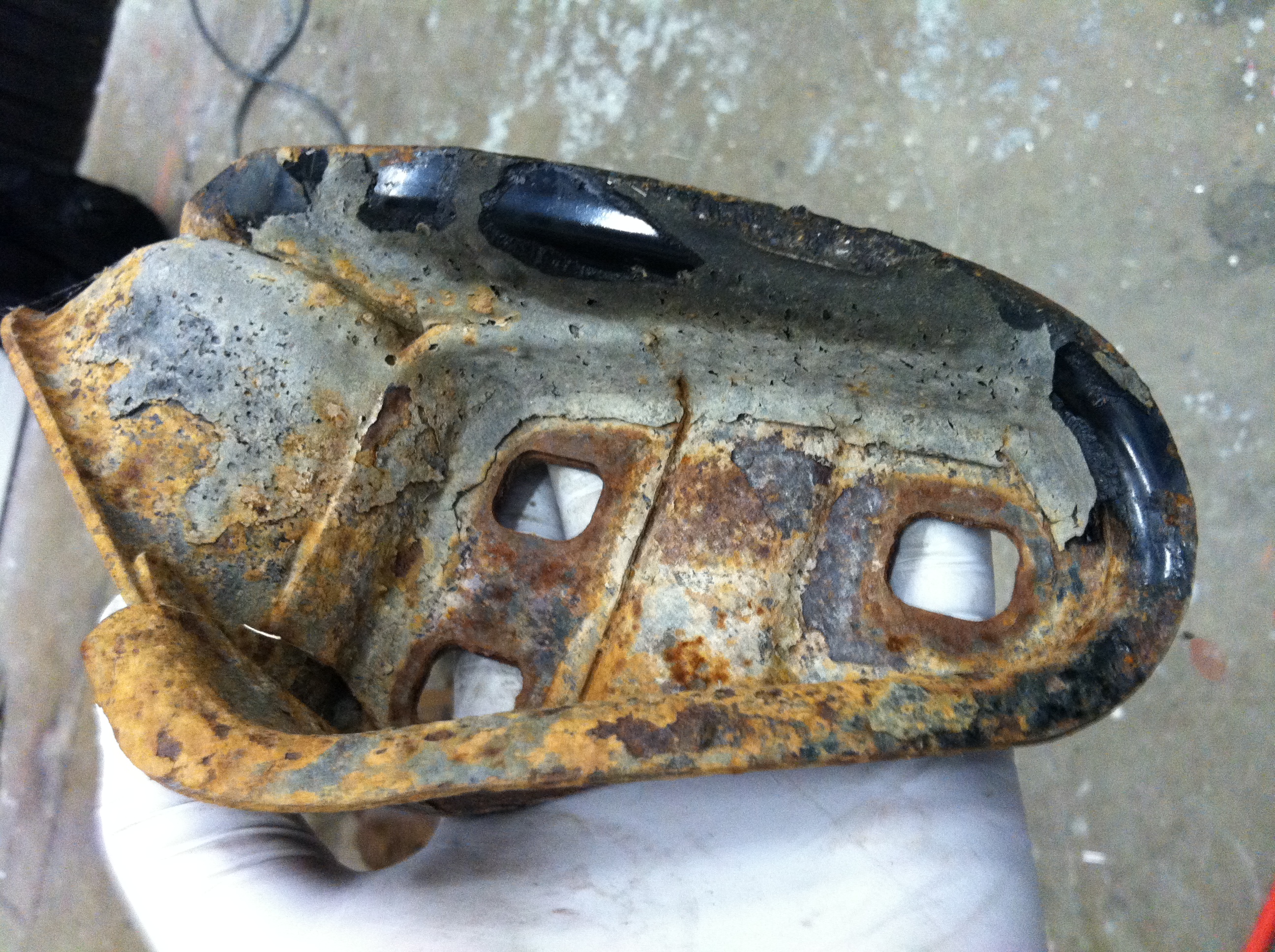

I am refurbishing the suspension on my 6 while the body is being finished and painted. I have noted while looking at different threads that folks usually finish the parts in a satin finish. Mine look to have been gloss black originally from what I can tell. So, what should the finish be?
Thanks, Bill |

Pat Garvey Satin Aug 8 2012, 04:18 PM
Peashooter
Satin
Thanks, Pat. Satin it will be.
This is an ... Aug 8 2012, 04:41 PM
1970 Neun vierzehn
Satin
This is an... Aug 8 2012, 05:48 PM
Pat Garvey
Satin
This is an... Aug 9 2012, 04:39 PM
Peashooter
[quote name='Peashooter' post='1721073' date='Aug... Aug 10 2012, 07:05 AM
Eric_Shea All of the stock suspension components we've h... Jan 24 2013, 08:11 PM
scotty b
All of the stock suspension components we've ... Jan 26 2013, 09:20 AM
Pat Garvey I'll stick with satin.
I know a number of ... Jan 28 2013, 07:46 PM
Eric_Shea You're entitled to you opinion... No matter ho... Jan 28 2013, 09:33 PM
Pat Garvey
You're entitled to you opinion... No matter h... Jan 29 2013, 07:11 PM
Pat Garvey
You're entitled to you opinion... No matter h... Feb 3 2013, 07:12 PM
tod914 I was just under the frog today, it does seem to b... Jan 29 2013, 01:46 PM
MDG
I was just under the frog today, it does seem to ... Jan 29 2013, 06:02 PM
Eric_Shea :toke: Jan 29 2013, 08:16 PM
tod914 Here's some reference.
http://www.914world.... Jan 29 2013, 08:56 PM
MDG
I suppose it comes down to what % of gloss = s... Jan 30 2013, 10:35 AM
scotty b I have to mix this shit for a living :
The genera... Jan 30 2013, 10:04 PM
Eric_Shea Powder is a tough finish but, agreed, it's too... Feb 5 2013, 08:32 AM
tod914 So 60% gloss then? May 9 2013, 09:00 PM
rgalla9146
So 60% gloss then?
I'm with Eric and Tod....... Jun 5 2013, 09:46 PM
DennisV
So 60% gloss then?
Has anyone sprayed out the Ea... Jul 10 2023, 11:22 AM
DennisV If anyone is curious, here is a side-by-side compa... Jul 18 2023, 05:50 PM
