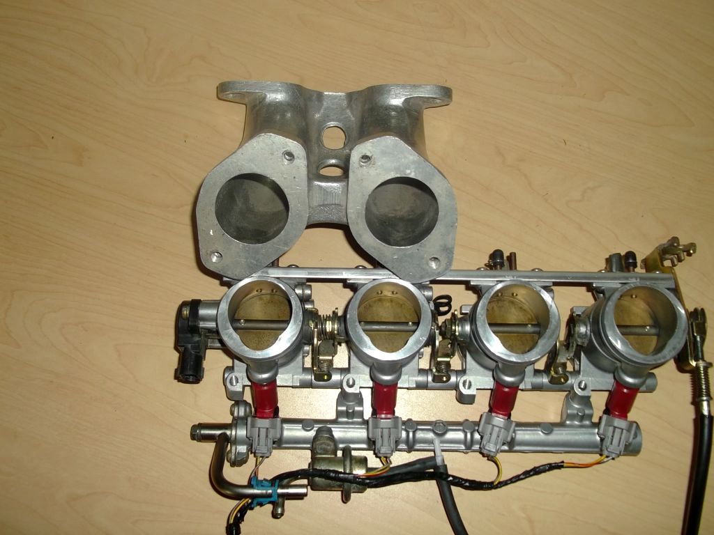

I need some TB's for my 914/4 type 4 into bug project engine.
Jenvey, Extrudabody and TWM TB's are crazy frickin' expensive for what they are, so I'm going the Motorcycle TB route.
This is what came in the mail today, stuff looks real good (IMG:style_emoticons/default/piratenanner.gif)
Mark Henry
post May 10 2013, 11:01 AM
that's what I do!
Posts: 20,065
Joined: 27-December 02
From: Port Hope, Ontario
Member No.: 26
Damn... you think they would get the spacing correct (IMG:style_emoticons/default/mad.gif)
80mm center to center spacing..... (IMG:style_emoticons/default/sad.gif) I need 90mm....
