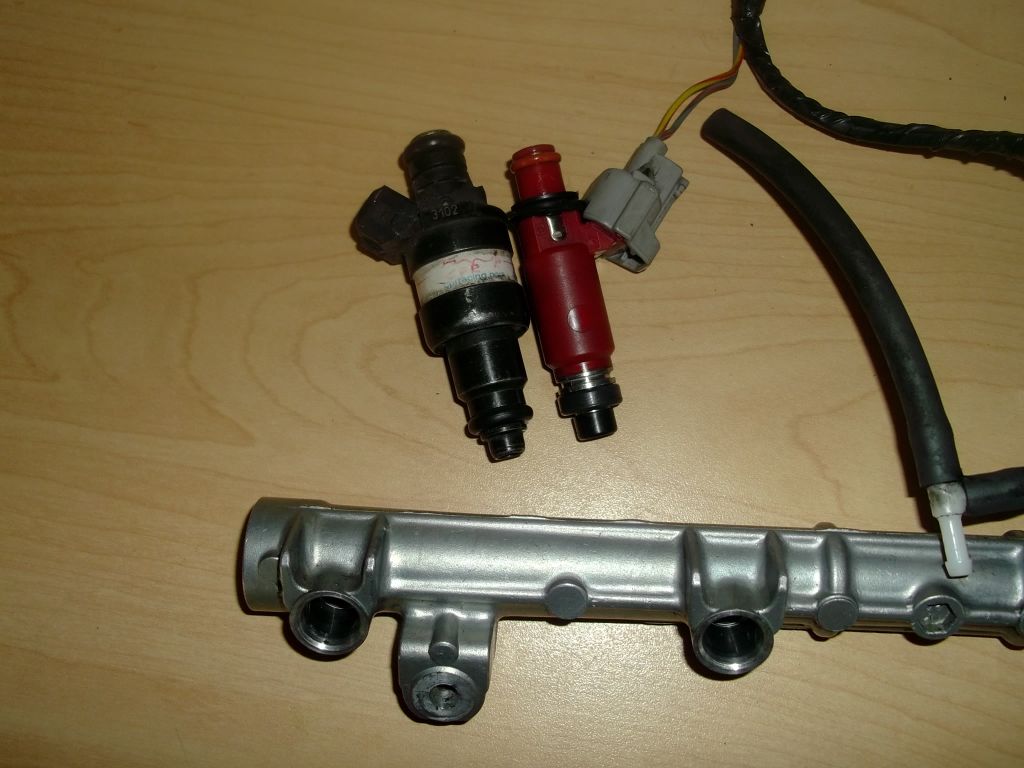

I need some TB's for my 914/4 type 4 into bug project engine.
Jenvey, Extrudabody and TWM TB's are crazy frickin' expensive for what they are, so I'm going the Motorcycle TB route.
This is what came in the mail today, stuff looks real good (IMG:style_emoticons/default/piratenanner.gif)

The bike injectors are shorter and I don't know if the fuel rails have enough meat to be cut an tapped for pipe threads.
The seals area bit different as well but think it's workable.
The bike injectors are only 22lbs the black injectors are 50lbs
