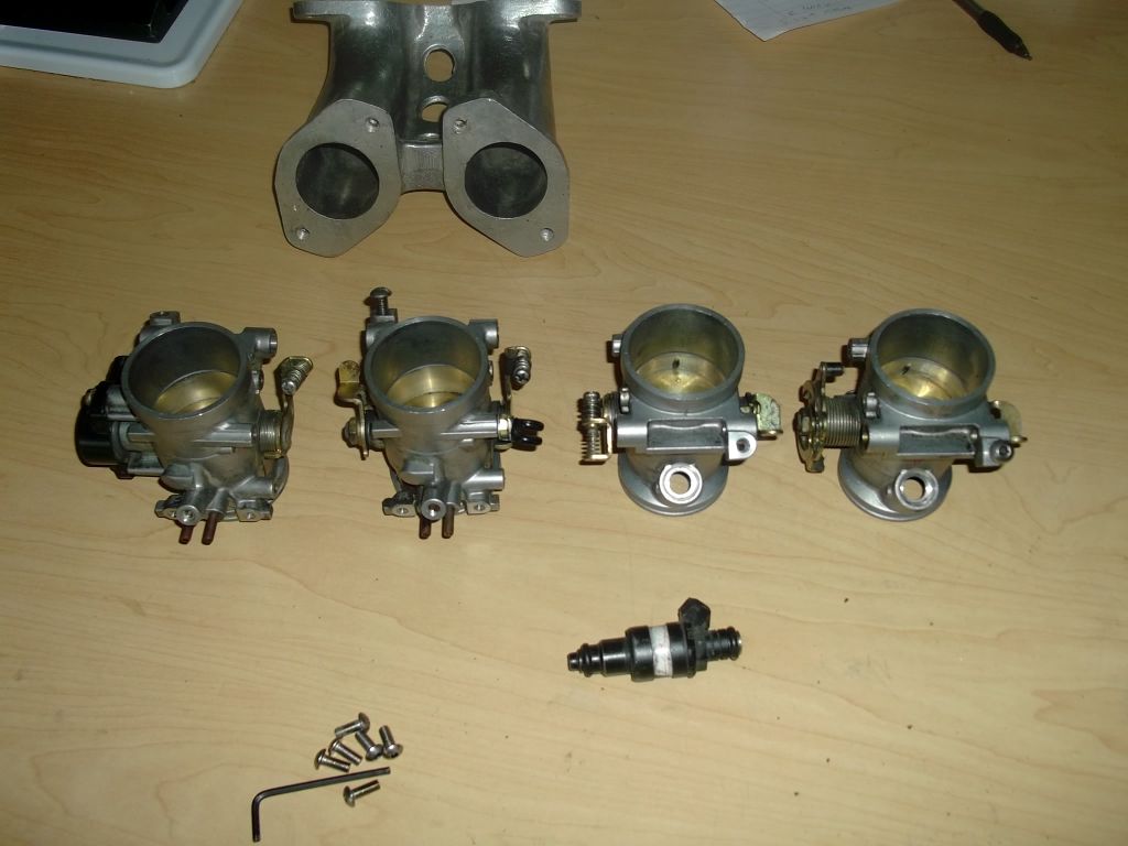

Like I need another project... Beginning to be as bad as Dr Evil (IMG:style_emoticons/default/laugh.gif) ... (IMG:style_emoticons/default/huh.gif) ... (IMG:style_emoticons/default/unsure.gif)
I need some TB's for my 914/4 type 4 into bug project engine.
Jenvey, Extrudabody and TWM TB's are crazy frickin' expensive for what they are, so I'm going the Motorcycle TB route.
This is what came in the mail today, stuff looks real good (IMG:style_emoticons/default/piratenanner.gif)

Take them all apart and i have 4 separate ITB's (IMG:style_emoticons/default/shades.gif)
