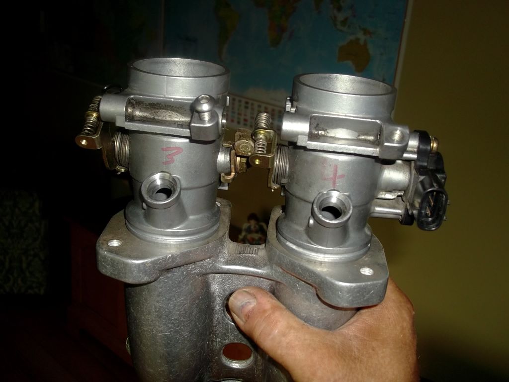

I need some TB's for my 914/4 type 4 into bug project engine.
Jenvey, Extrudabody and TWM TB's are crazy frickin' expensive for what they are, so I'm going the Motorcycle TB route.
This is what came in the mail today, stuff looks real good (IMG:style_emoticons/default/piratenanner.gif)

Going to take a bit of (IMG:style_emoticons/default/smash.gif) but I'm thinking these are going to work out beauty. (IMG:style_emoticons/default/smile.gif)
