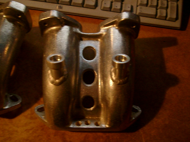

You should get a set of these:
(IMG:http://www.914world.com/bbs2/uploads/post-11-1124689756.jpg)
That way, you can run the big injectors where they should be, close to the intake valve, and use the TBs to regulate the air.
