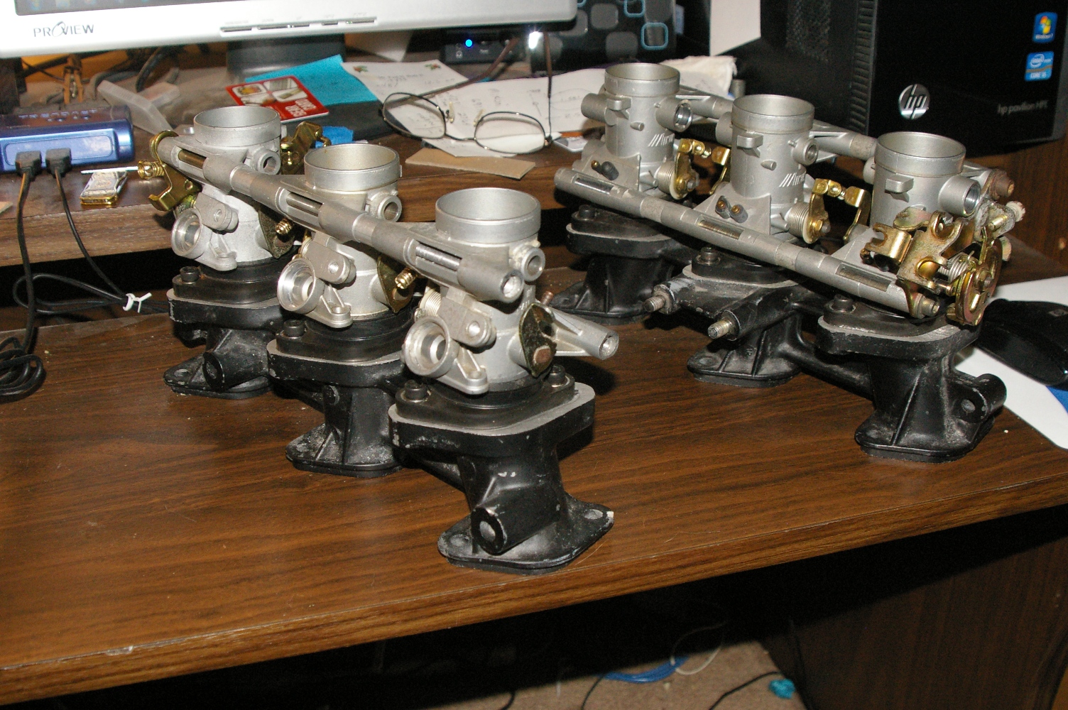

Like I need another project... Beginning to be as bad as Dr Evil (IMG:style_emoticons/default/laugh.gif) ... (IMG:style_emoticons/default/huh.gif) ... (IMG:style_emoticons/default/unsure.gif)
I need some TB's for my 914/4 type 4 into bug project engine.
Jenvey, Extrudabody and TWM TB's are crazy frickin' expensive for what they are, so I'm going the Motorcycle TB route.
This is what came in the mail today, stuff looks real good (IMG:style_emoticons/default/piratenanner.gif)

Or mill of the flange of the manifolds and use a rubber coupler like the bikes do (IMG:style_emoticons/default/smile.gif)

Boy, EFI ITB's is like a sickness. I started my project for my "Tail Dragger" a month or so ago with Suzuki GSX R600 ITB's. Lot's of threads on the Bird Board. I used the stock rubber couplers and redrilled the mounting holes on the manifolds.
