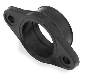

You need some of these...
(IMG:http://www.914world.com/bbs2/uploads_offsite/e.ridersdiscount.com-10496-1368235292.1.jpg)
http://www.ebay.com/itm/Bikers-Choice-2-Bo...ies&vxp=mtr
