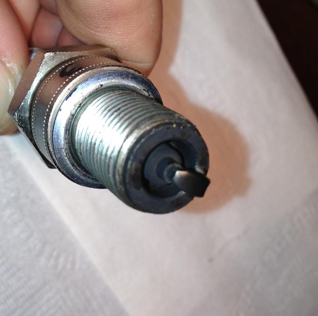

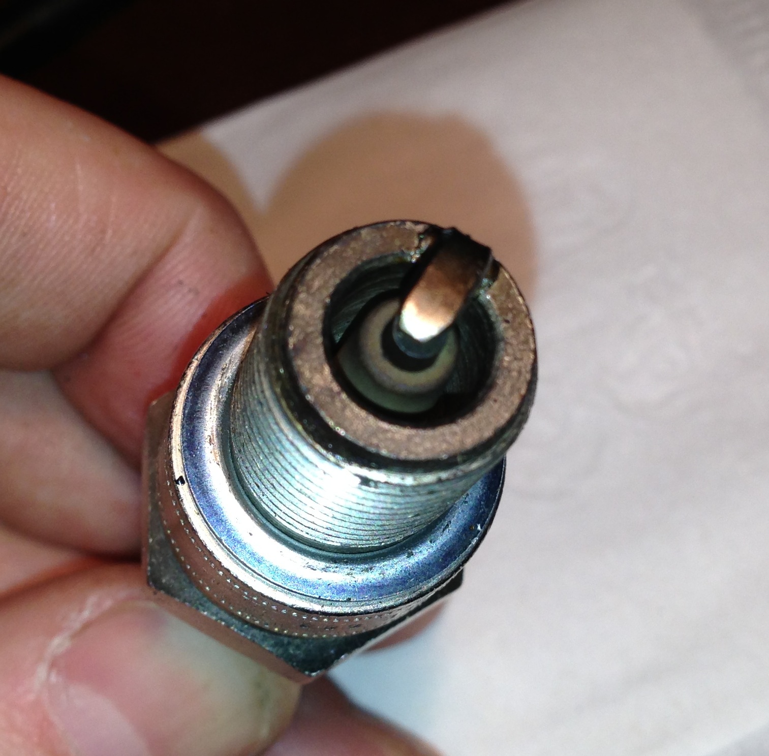

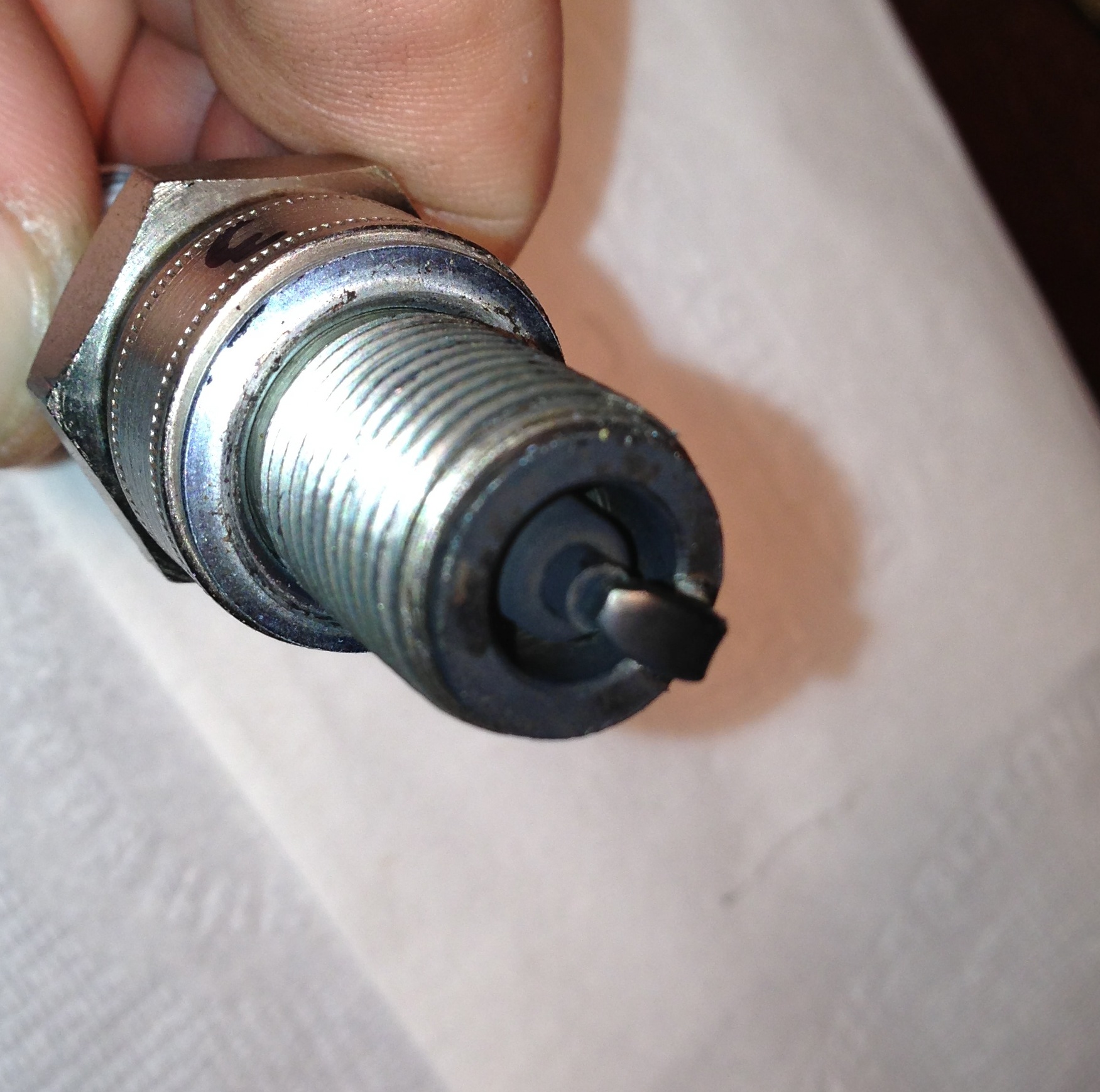

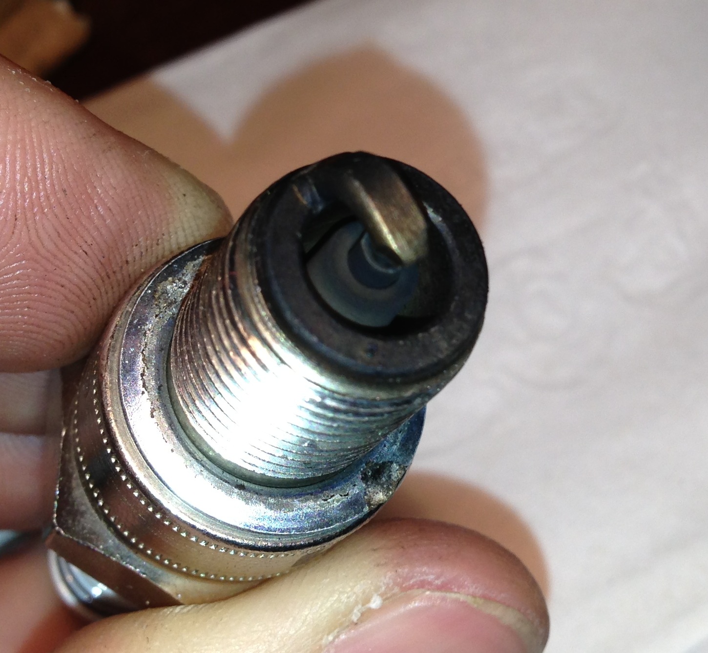

I pulled the plugs to reset the gaps and looking at the tips, I see a big difference between the 1-2 side Vs. 3-4. I don't know squat about reading plugs so I offer up some pic's for the experts...
Plug 1
Plug 2
Plug 3
Plug 4
There doesn't seem to be much going on in Cyl's 1&2. I'm not sure what to make of 3&4.
It smells rich in general.
Any feedback would be greatly appreciated.
