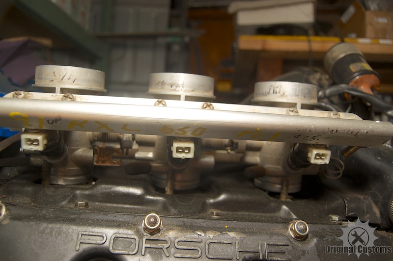

Mark Henry   I was making good progress, but work got in the wa...   Nov 21 2013, 07:38 PM
Mark Henry   ITB without filters   Nov 21 2013, 07:40 PM
Mark Henry   ITB with filters   Nov 21 2013, 07:41 PM

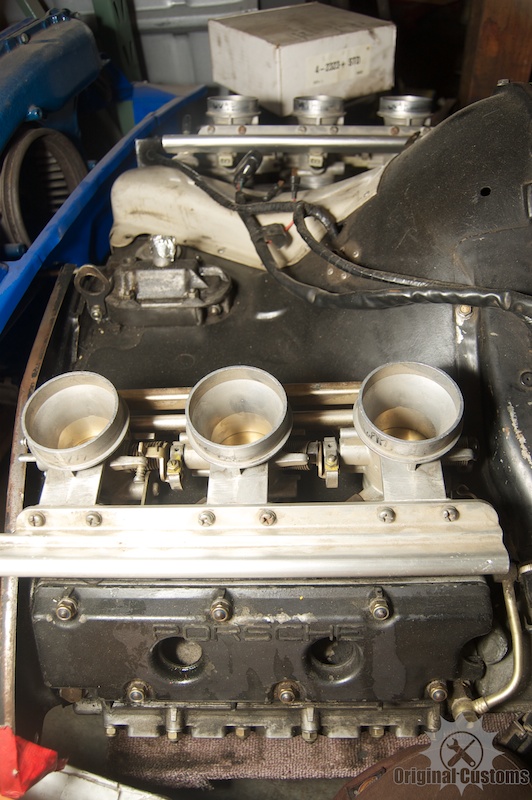

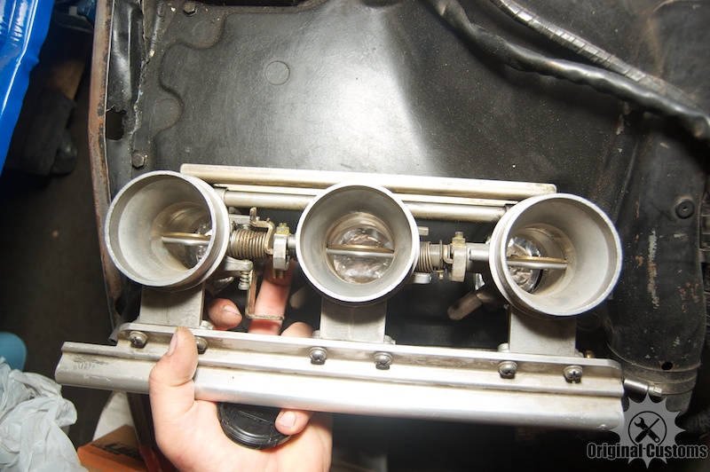

Mark Henry   down the throat. I am having issues with clearanc...   Nov 21 2013, 07:46 PM
r_towle   Flip them, put the rail in the inside   Nov 21 2013, 08:50 PM
Mark Henry   Flip them, put the rail in the inside You reall...   Nov 21 2013, 09:50 PM
Dr Evil   Mark, you need to place them so that air will past...   Nov 21 2013, 10:15 PM
Mark Henry   Mark, you need to place them so that air will pas...   Nov 21 2013, 10:20 PM

Mark Henry   It's alive :thumbsup:   May 14 2014, 11:24 AM
