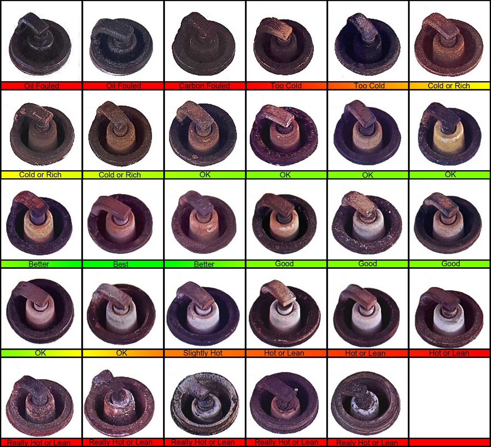

Bob L.   I have some new info. I pulled the plugs to reset...   May 11 2013, 01:06 PM
rick 918-S   Replace the cap, rotor and wires. Recheck the valv...   May 11 2013, 03:11 PM
r_towle   Valves and dwell affect timing. Car will run so m...   May 11 2013, 07:19 PM
Bob L.   OK, I replaced the points, Cap and rotor. Wires an...   May 12 2013, 06:51 PM
jmill   Handy dandy chart.   May 12 2013, 08:40 PM
