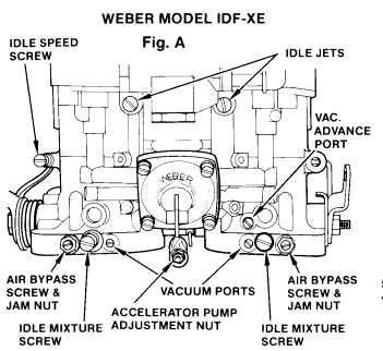

If you can partially mitigate the symptoms by engaging the pump jets, then one or more throats is going lean on the main fuel cirucut.
It actually sounds like the opposite Chris. He's going lean when he stomps on it like the pump jets aren't supplying enough fuel. Check your pump adjustment nuts. Might be too loose on the carb that pops.

rhodyguy   george, are the end washers, item #30 in the explo...   May 17 2013, 09:54 AM
ThePaintedMan   From all the diagrams and stuff I've poured ov...   May 17 2013, 01:05 PM
r_towle   Early style carbs have three or four different acc...   May 17 2013, 02:20 PM

ThePaintedMan   The only other things I want to take a look at whe...   May 23 2013, 06:17 PM
jmill   If I recall correctly there is a ball check in #10...   May 23 2013, 08:47 PM
r_towle   position 2 "would" make the lever depres...   May 24 2013, 07:33 AM
ThePaintedMan   position 2 "would" make the lever depre...   May 24 2013, 08:50 AM
