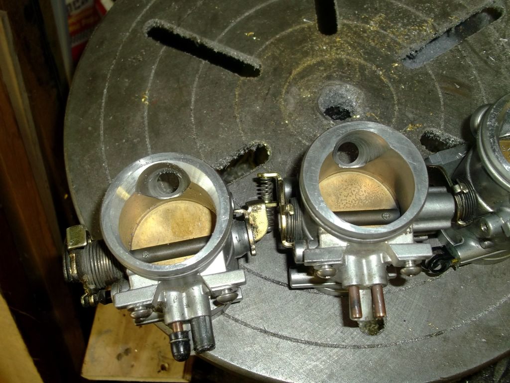

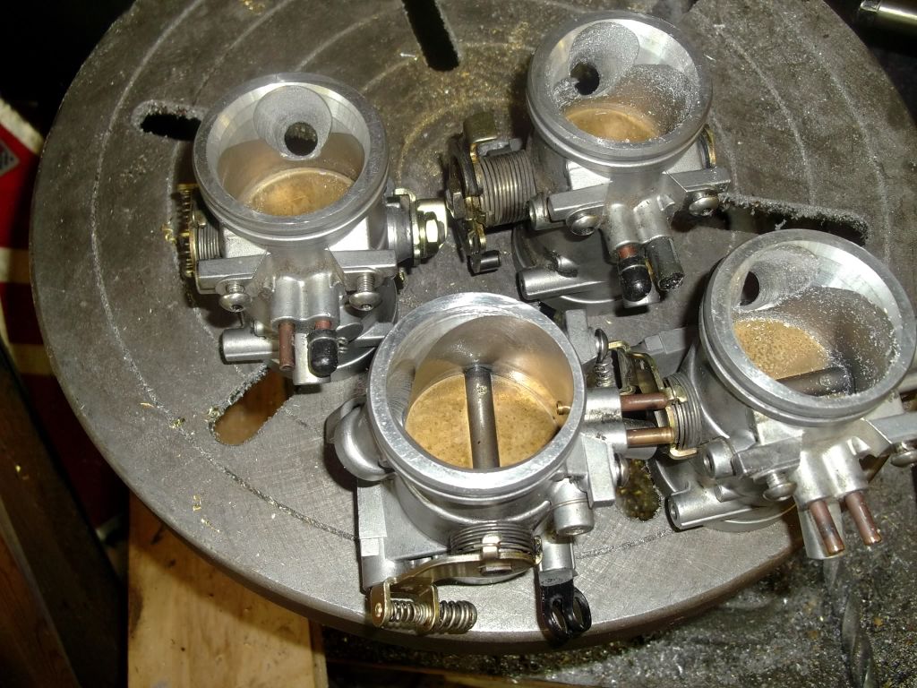

I didn't like the funky shape on the bottom of the TB so I did some profiling today. (IMG:style_emoticons/default/smile.gif)
Original shape is top right TB.
