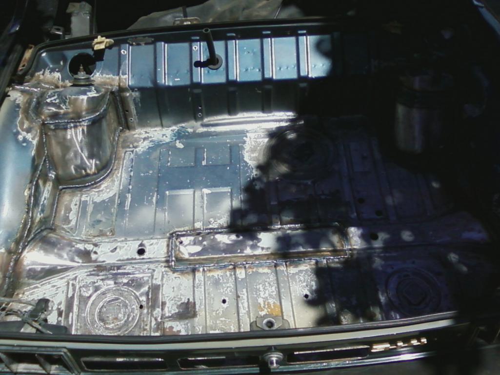

well I was able to get the shock tower seams welded up.
now I can install the oil system and finish up the relocated battery work.
