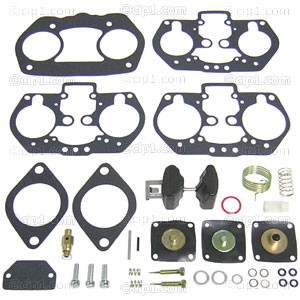

Just bombing around I see this fairly complete kit has three different sized diaphragms. No cams though.

r_towle   Just bombing around I see this fairly complete ki...   May 17 2013, 06:16 AM
