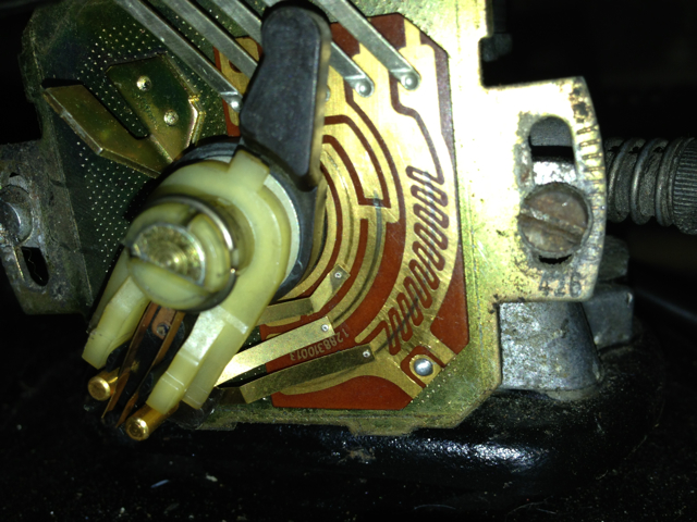

I took a Pic of the TPS. It doesn't look too bad to me, but someone may be able to tell better than me. Here it is
What should I check next? Would it help if I posted a video with sound?

Bob L.   I want to check my TPS reports. Is there a ref...   May 24 2013, 11:08 AM
Dave_Darling   Here: http://www.pelicanparts.com/techarticles/9....   May 24 2013, 12:49 PM
Bob L.   Here: http://www.pelicanparts.com/techarticles/9...   May 24 2013, 03:14 PM
Dave_Darling   There's no resistance on this particular part....   May 24 2013, 05:53 PM
Bob L.   There's no resistance on this particular part...   May 24 2013, 08:19 PM
Bob L.   O.K.! The TPS is adjusted. It did h...   May 25 2013, 05:02 PM
