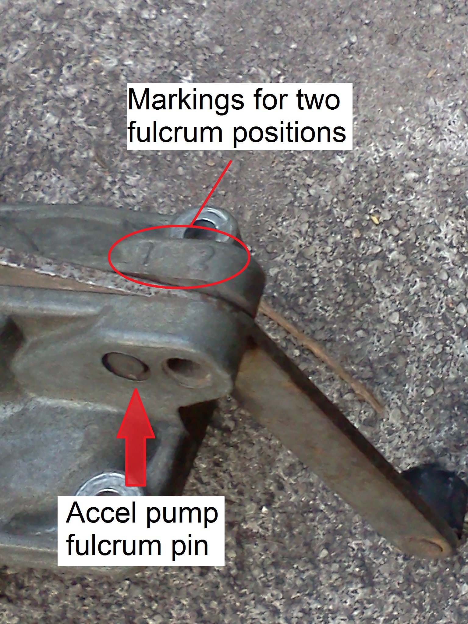

So, I've pulled off one of the accelerator pump covers, praying that somehow I had installed the later style diaphragm designed for the adjustable lever rod, but I did not. As I mentioned, it's definitely the earlier style diaphragm, which, as Rich suggested, may come in a range of sizes. Getting the right one from the right supplier is probably a crapshoot. I do have two new diaphragms, which I'll install anyway, but below I've posted a picture of something interesting.
I've known that these style accelerator pumps have two different positions for awhile, ostensibly to provide more/less volume depending on application. The question is, which one is which? Do any of you have the fulcrum pin in the #2 position in the picture above? Tim's carbs have it in #1, which is the only reason I'm hesitant to try to move the pin on my carbs.
