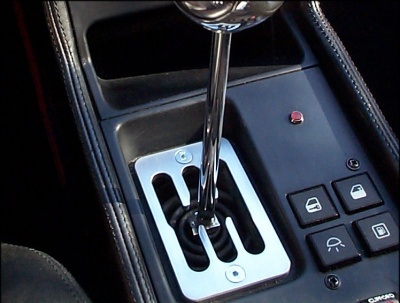

I've got a friend who races a 912. He blew his motor twice in the same year when he missed a shift and over reved the motor. His soulution was to spend more $$'s and install a Ferrari type shift gate. I don't know who the maker was, but I do remember he said the cost was about $3000.
