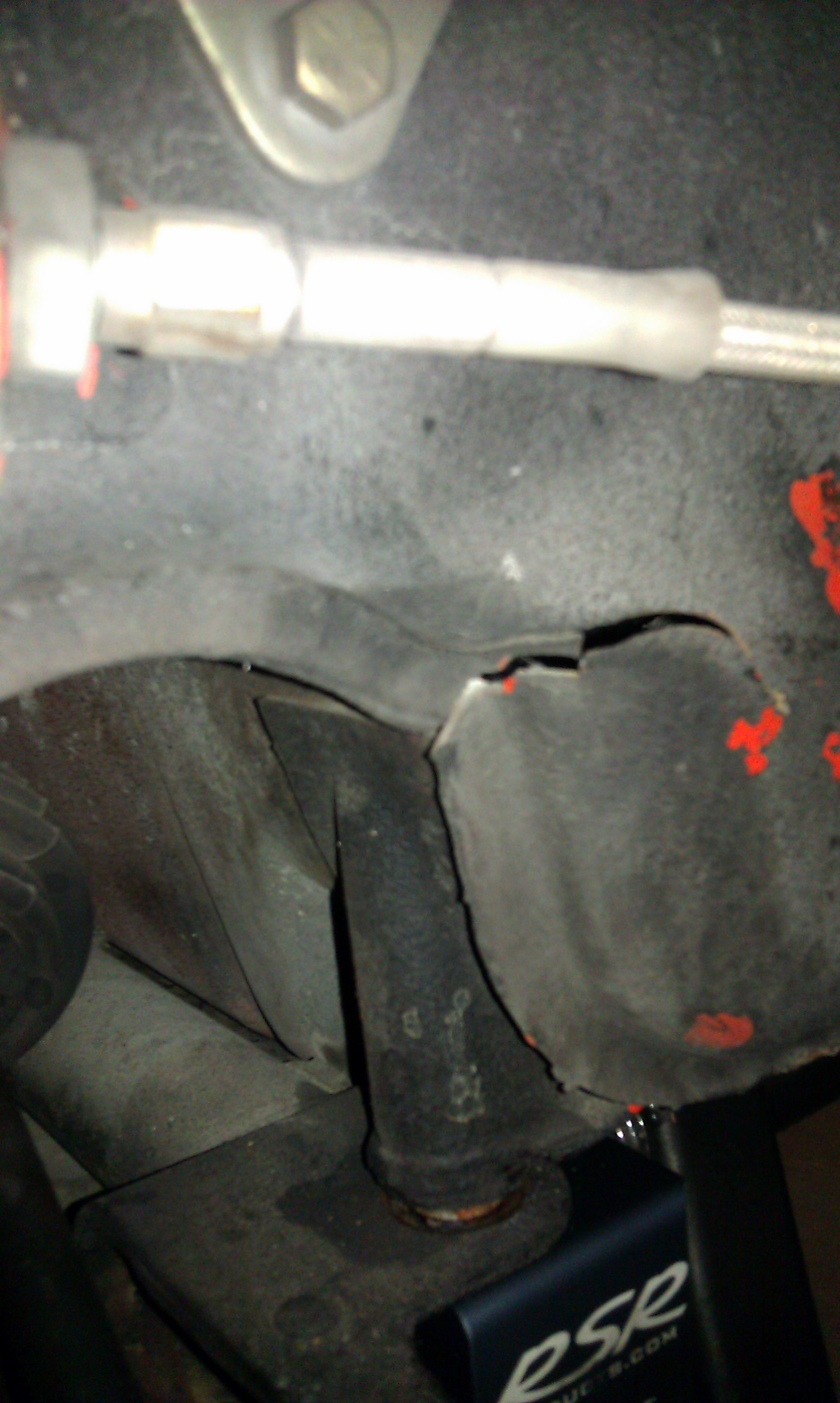

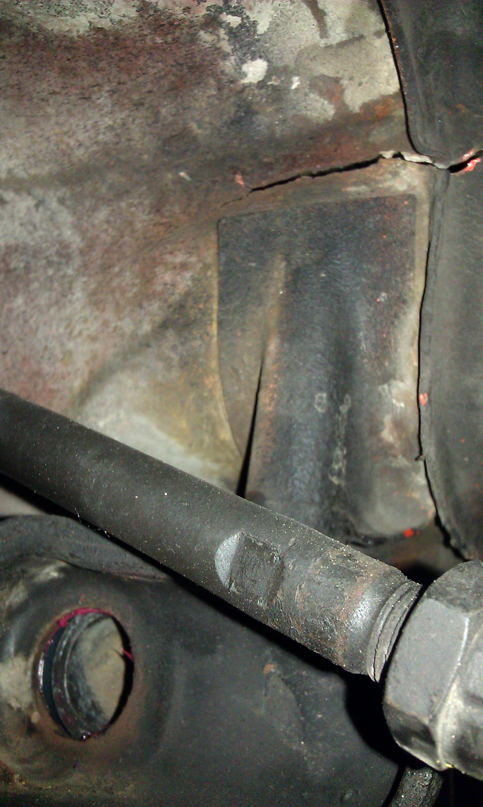

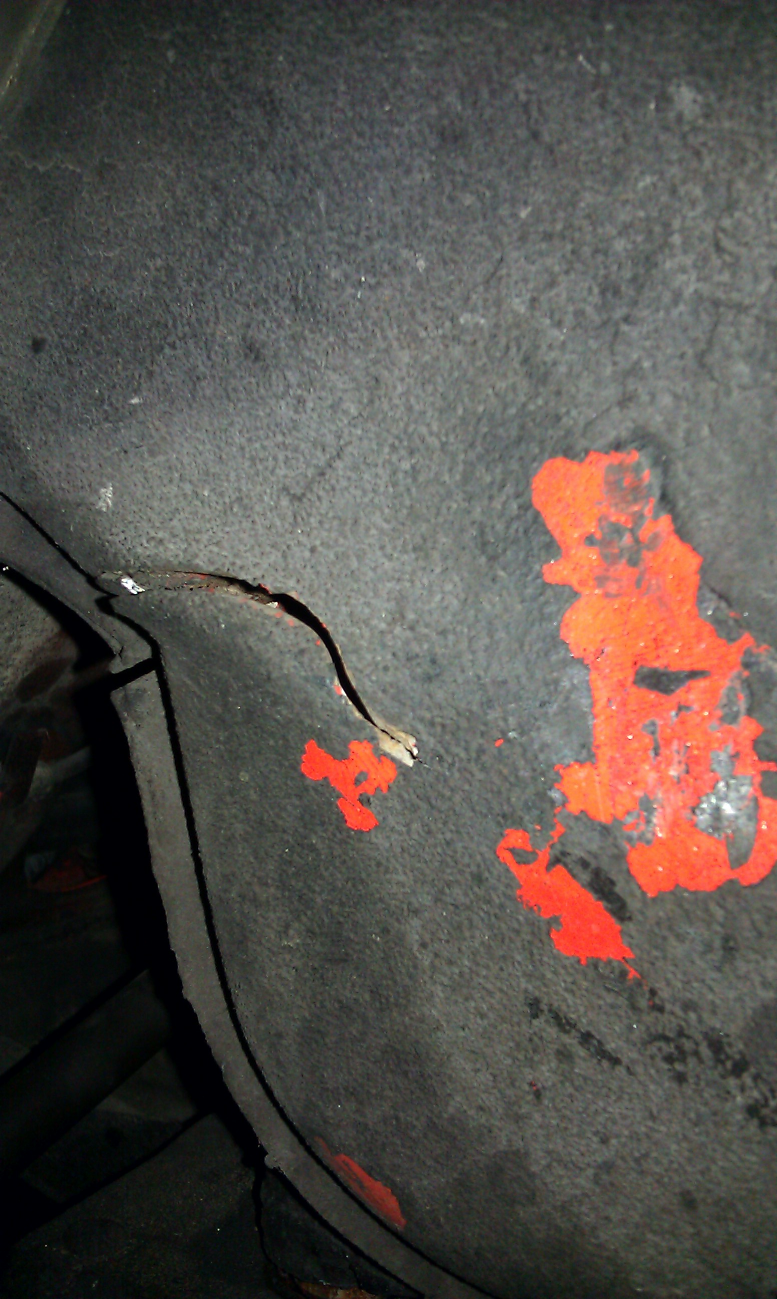

Anyone else notice the crack in this picture? I have known it was there for some time as you can see it in the front trunk but after examing it closer due to a bit of binding when installing the new bushings on that side it seems like it might be related to the poly bushing freezing up as well, I am guessing also related to the damage to the sway bar tab. I suspect that due to lack of front suspension movement the swaybar tab was at times acting as a fulcrum causing the suspension crossmember to be pulled away from the chasis. The tear goes right across the top of the mount for the crossmember. The binding when installing the new bushings was due to the control arm wanting to angle up towards the front of the car. As this can not be corrected with the adjusting washers I had to take a 2x4 and a sledge to see if I could straighten it out a bit. Its slightly better now but not great, nowhere near as free moving as the drivers side. Oh well, just have to live with it for the moment as I am pressed for time. I know of a shop in town with a celette bench, might have to make an appointment this winter to get it straightened and stiched up.

As the crack has been there for quite a while I am not to concerned to autox with it a few more times, has not seemed to be getting any worse. Think i might have to sit it out next year though if i dont get this taken care of this winter.
Looks really nasty in close ups.
Anyone else seen this sort of thing before?

76-914   At least "stop drill" that crack.   May 29 2013, 08:11 AM

Eric_Shea   RE: Crack - Call Troy and get it in. I think he h...   May 29 2013, 09:36 AM
JamesM   RE: Crack - Call Troy and get it in. I think he ...   May 29 2013, 10:06 AM
