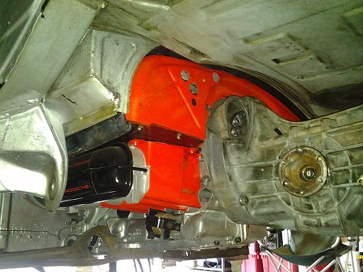

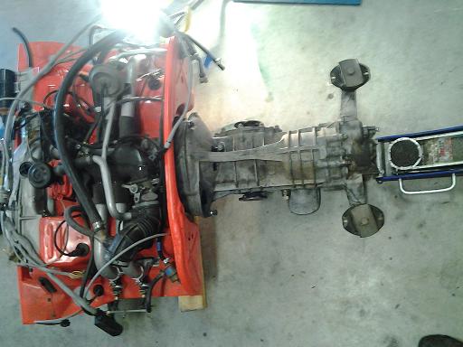

It's done....Took 9 beers, 1.5 hours with a couple friends and my 17 year old son. Surprisingly, we were forced to use a combo of ENGINE UP and CAR DOWN. I had a transmission jack from another friend that just would not lift the weight of the engine and tranny to it's full height.
Got the engine to the floor, raised the tranny end with a 2x4 then inserted the tranny and torqued it up.
Lifted the new assembly onto the tranny jack and balanced it. Moved everything to the car and started lifting. Eventually we determined that it was not going any higher. So one friend LIFTED the rear of the car and we lowered the jack stands 2 notches, then again, one more notch and started bolting everything up....DONE.
