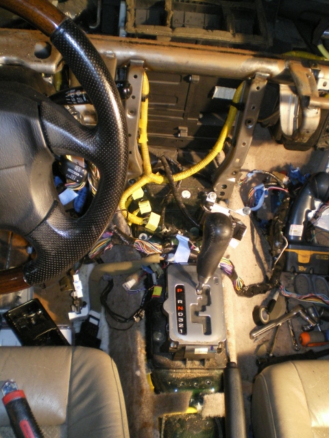

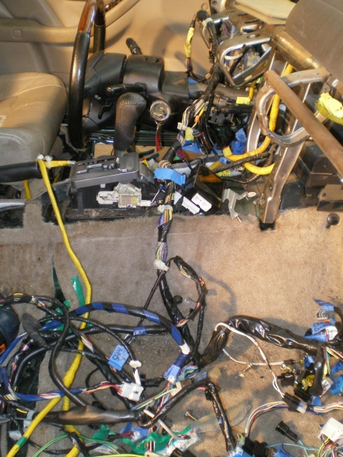

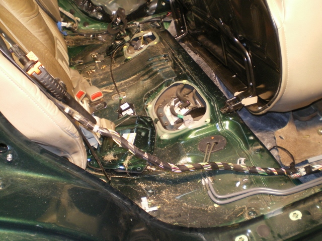

Chris, I'd have to agree with you on the wiring harness being a PITA. This is the starting point for me. After my daughter's graduation, family and entourage left 5/22. Miss them but it was time to begin the all out assault on the Suby. I was pussy footing around the first week or so, then out came the sawzall. I never would have been able remove the dash w/o one. Just like any predator I began at the rear and worked my way forward. I try to gather as much info on my own as possible before posting on the Suby boards. Those guy's will flame you in a second. Makes me appreciate each one of you guy's here. So, I began with exposing and removing the wiring from everything that is not conditional to the engine running. i.e I pull a plug and start the car. If it doesn't start I reconnect just that plug and move on to the next while identifying each wire as I go.

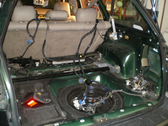

This is the harness that passes along the lower R side. Upper R side is Moon and Sun Roof wiring which I won't be using. This harness catches the rear running lights, rear washer & WW's, fuel pump/sender, misc evap vac/press sensors, and rear door motors/switches/locks.
Here it passes alongside the rear psg seat and on to the rear. The access ports for the fuel sender and fuel pump are shown here. The harness that feeds this wraps around the back seat and then enters on the rear L side???? Seems the long way around but.........

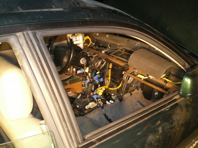

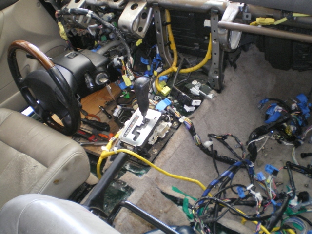

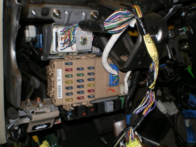

Some carnage shots. After all this I am to the point of pulling the engine. Did anyone notice the gage cluster is removed. Cars still starts and runs. Blew my mind. FWIW, the yellow harness' are the air bag/restraint system. Also, plastic squirt and roof drain lines are overhead L side along with most audio lines. Good idea! Separate power and water as well as RF interference.

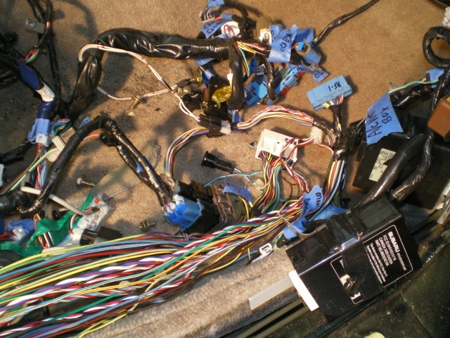

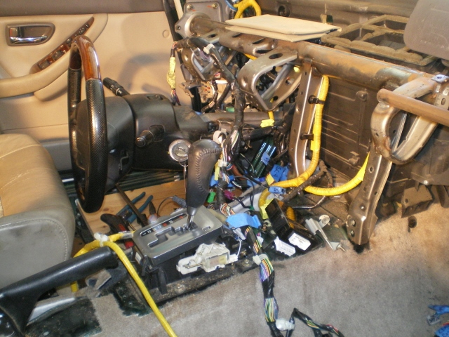

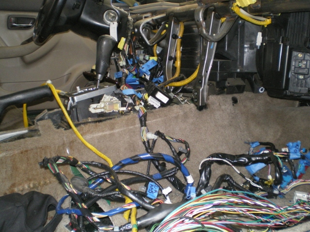

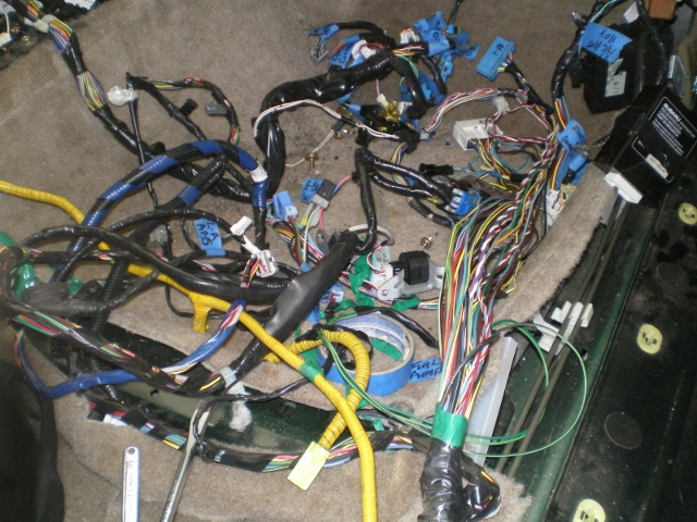

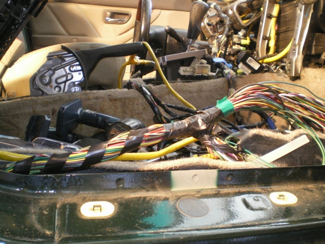

76-914   Well I finally got the last wiring harness out. If...   Jun 17 2013, 08:48 AM
bulitt   Dear God.   Jun 17 2013, 09:07 AM
Chris H.   Kent, I know that feeling but you are doing great....   Jun 17 2013, 09:18 AM
ruby914   Piece of cake. :D Learn how to open the connector...   Jun 17 2013, 07:56 PM
76-914   Thanks guys, good info. And I hope that I pulled o...   Jun 17 2013, 09:35 PM
