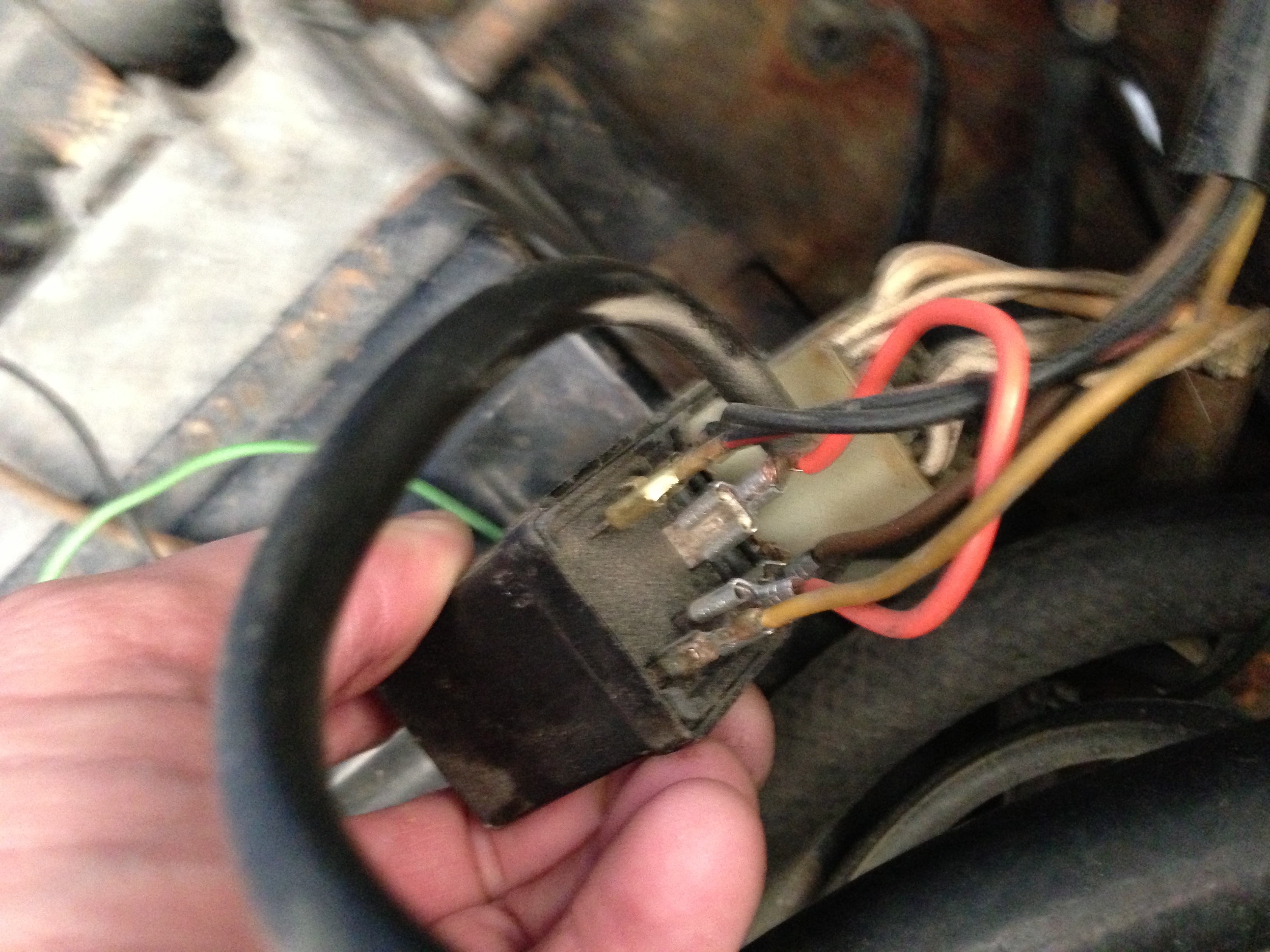

QUOTE(timothy_nd28 @ Jun 5 2013, 12:13 PM) *
Good, now remove that jumper. We need to move the jumper to pin 88z on the dual relay to the positive battery post. Try that, and post your findings.
Did as told, and no noise, no movement, no love. Attached a picture of the dual.
88z is in the middle with red and black together.
JAAAttached Image

timothy_nd28   Yep, looks like 88z is the pin that shares the red...   Jun 5 2013, 02:14 PM
