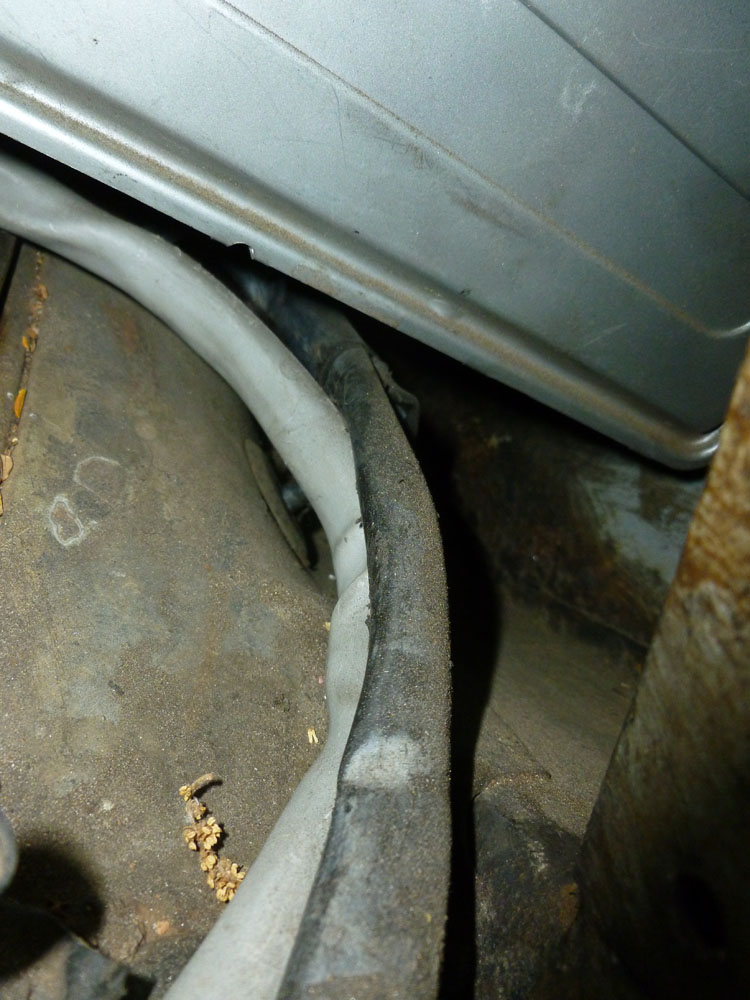

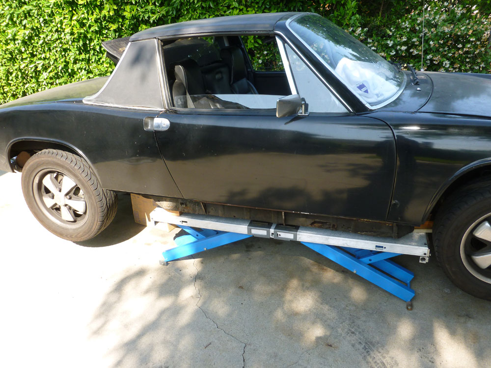

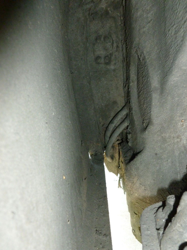

Hello,
I have been trying to find someone who knows 914's in the Los Angeles area.
I had an accident a few weeks ago, damaged the front (see images).
I have been collection the parts for the repair. I have been asking everyone around here for a shop that knows 914's but not much luck, mostly 911 shops.
Along with the front end damage, I have a few rust issues that need to be addressed.
I found shops that are willing to do the front end repair but not the rust damage.
One of the shops would not touch the car unless I did a full rotisserie restoration. I don't have the funds for that extensive a project.
The rust is concentrated in the outer longs area (see images)
I am pretty competent with the 914 mechanicals. I have owned this car for 31 years and have been wrenching it myself, (only other person to do any work on the car in 30+ years is the guy I trust to do my wheel alinements).
I am trying to find someone close to the Los Angeles area that has done this before and knows 914's hopefully as well as I do.
Thanks in advance for any info you may have.
Mike

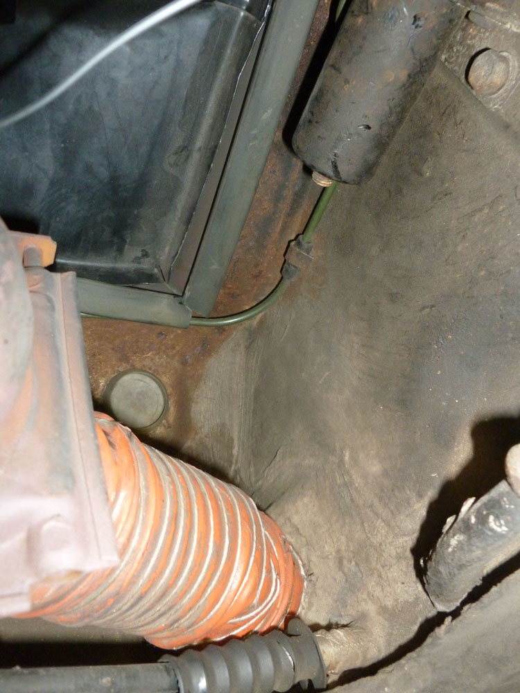

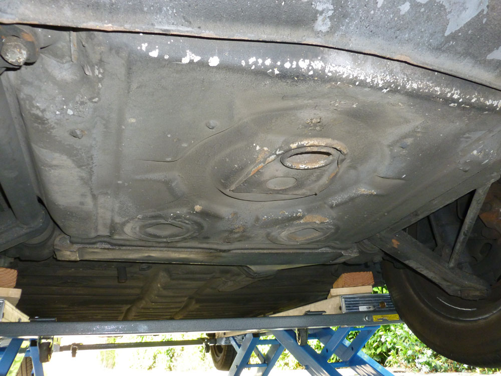

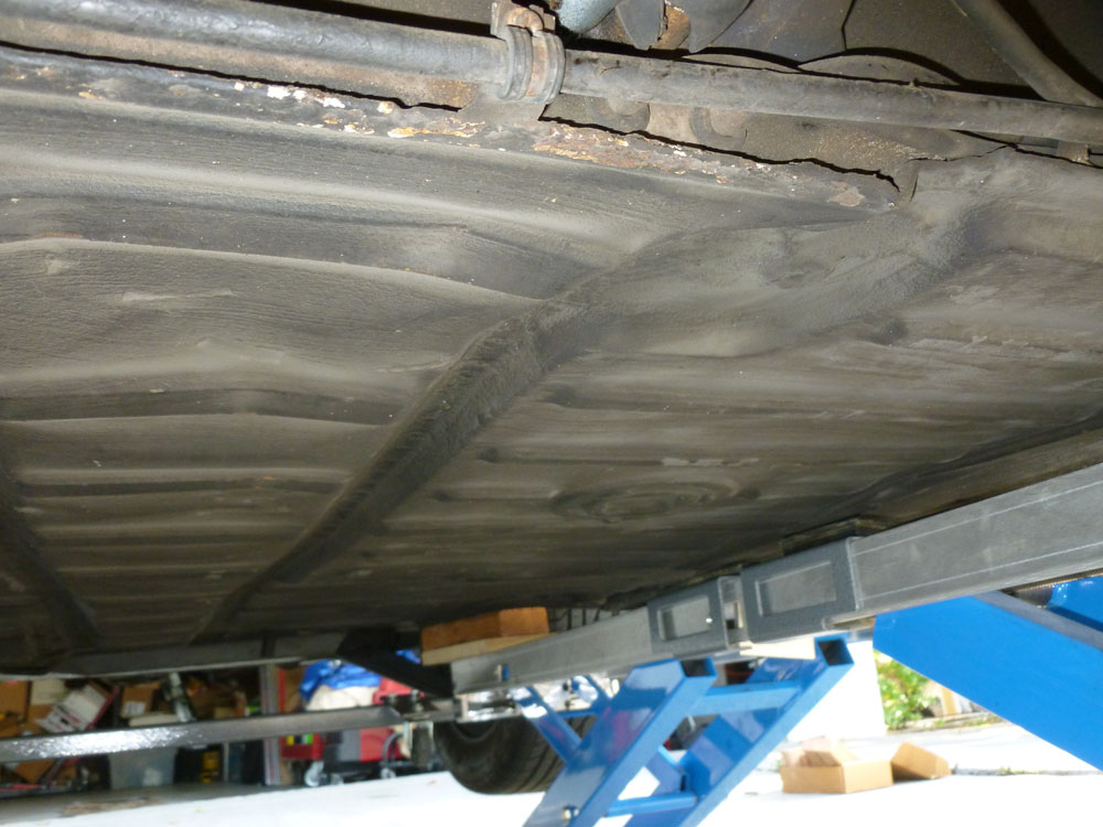

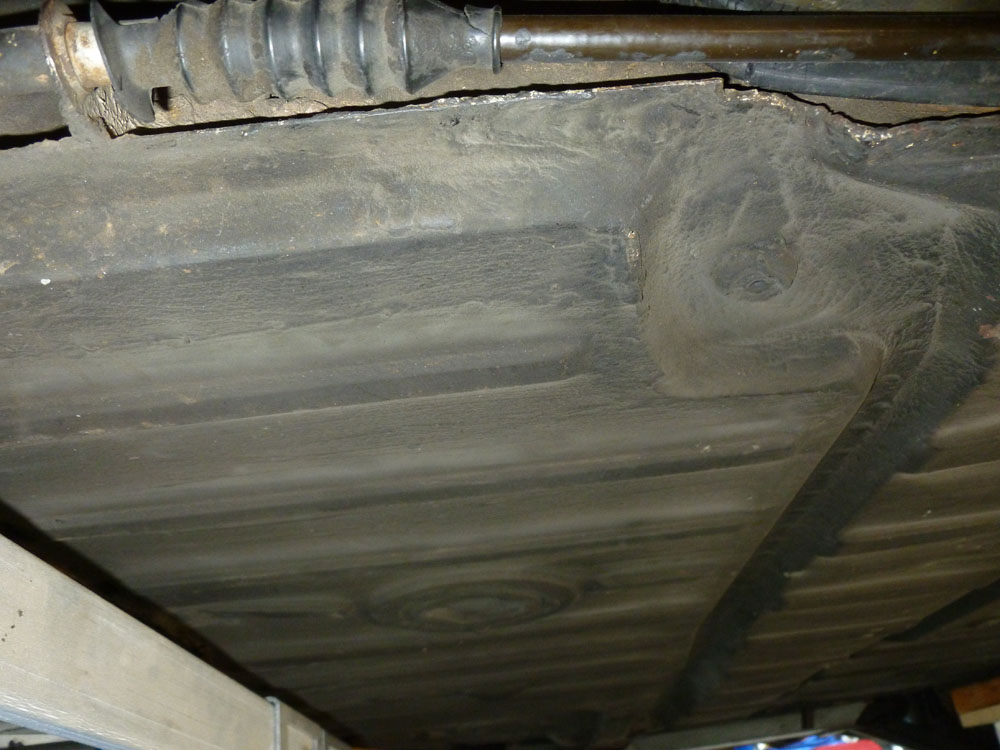

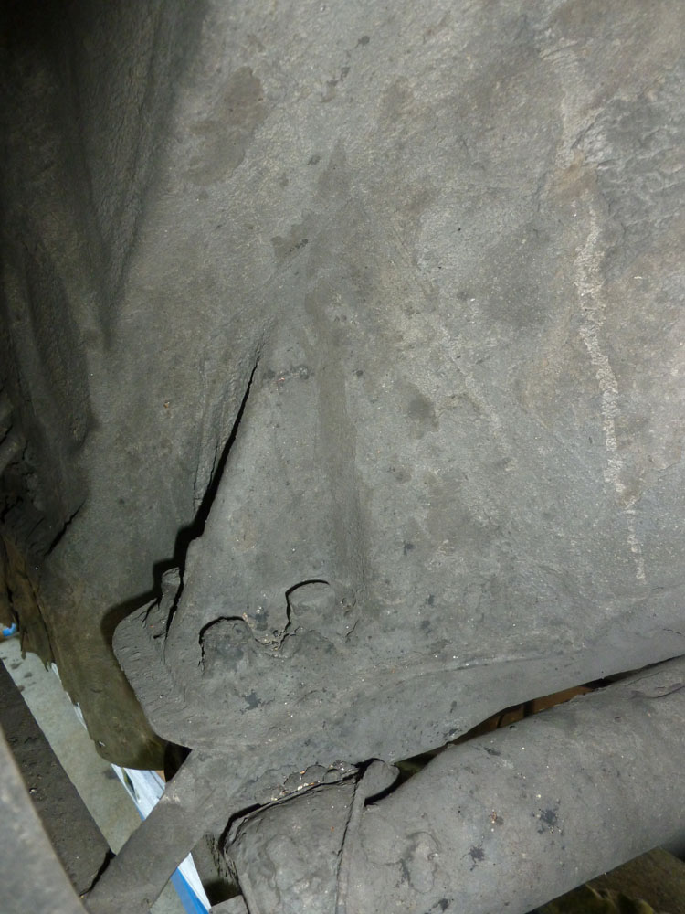

I am in the middle of changing the engine oil so I took a few more photos of the bottom of the car.
The only rust spot on the entire floor is the throttle peddle reenforcement bracket.
No rust in either side hell hole, original plastic drainage plugs!

nathansnathan   That tub has had it, man. That rust is bad, like c...   Jun 7 2013, 11:52 AM
Andyrew   Your looking at 5-10k to repair the rust. Thats no...   Jun 7 2013, 12:15 PM
David Stowers   That must really flex, I'm surprised the doors...   Jun 7 2013, 12:23 PM

GeorgeRud   You may have actually done yourself a favor by hav...   Jun 7 2013, 01:55 PM

SirAndy   The only rust spot on the entire floor is the thro...   Jun 7 2013, 06:21 PM
mepstein   What your seeing is the tip of the iceberg. ...   Jun 7 2013, 06:23 PM
