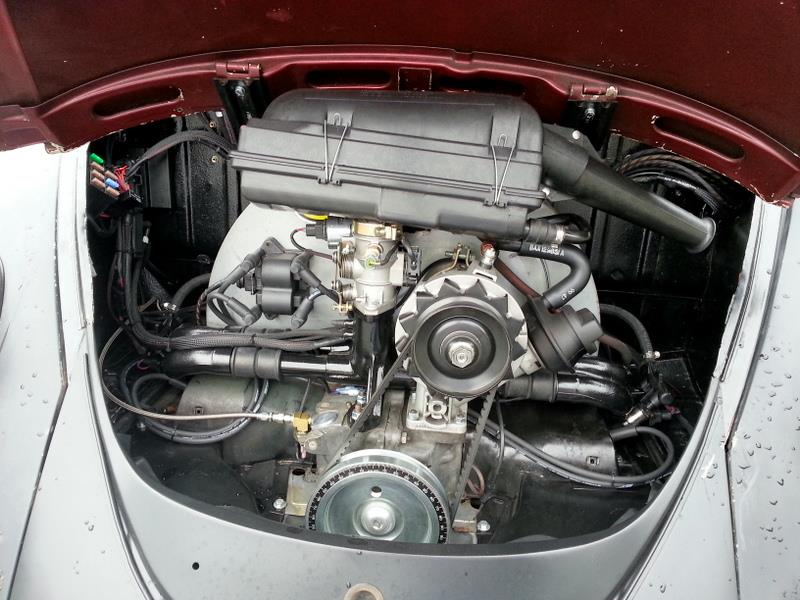

I've only recently played with the Microquirts. My goto is an MS2 V3. The Microsquirt is a great little ECU but it is limited in features for anything over stock. For example, you cannot run a boost control and an idle valve. And if you want Barometric correction you can't do launch control.
Here is my 1600dp beetle with a Microsquirt installed. I dynoed it not to long ago and got 60hp and 87ft/lbs out of it.
(IMG:http://www.914world.com/bbs2/uploads_offsite/fbcdn-sphotos-a-a.akamaihd.net-15980-1370663068.1.jpg)

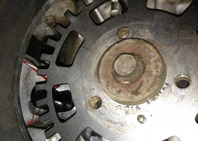

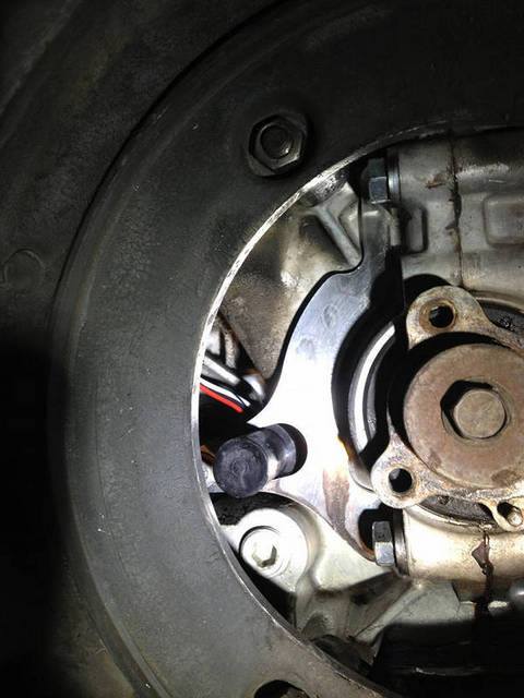

To answer some questions on the T4 trigger wheel, here are a couple pics of it mounted up.
(IMG:http://www.914world.com/bbs2/uploads_offsite/fbcdn-sphotos-b-a.akamaihd.net-15980-1370663068.2.jpg)
(IMG:http://www.914world.com/bbs2/uploads_offsite/fbcdn-sphotos-h-a.akamaihd.net-15980-1370663068.3.jpg)
