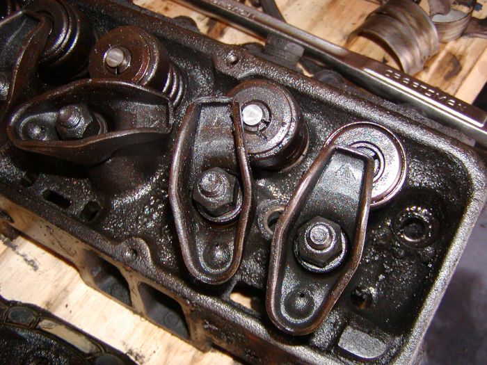

And finally valves!
whew.. Sorry andy/brad, admin team... Oh heck its only 2megs..
