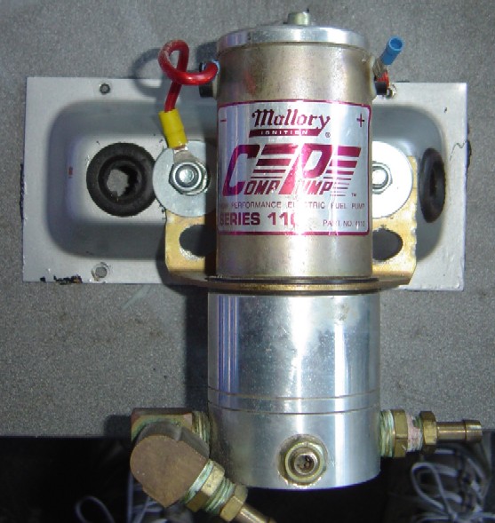

Here is the fuel pump I am going to install. It was graciously donated by a club member. You cant run the stock fuel pump with the water pump or alternator mounted the way Renegade does.

skline   Here is the fuel pump I am going to install. It wa...   Jul 8 2004, 08:33 PM
