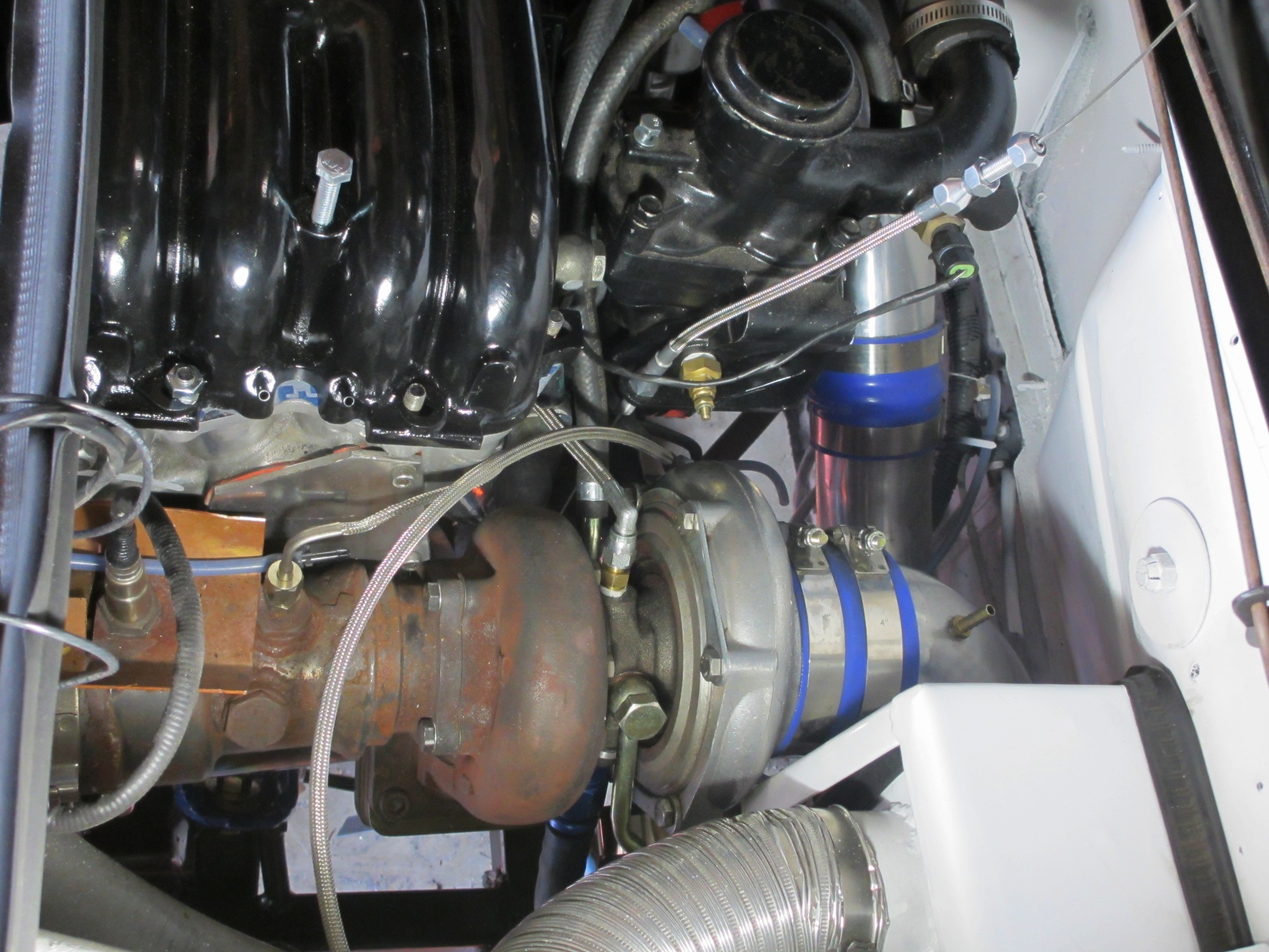

I use a copper heatsink on mine and have never had a problem. My WB O2 is mounted right after my turbo (8") and gets up to 1400° all the time.
You can see it here right after my EGT probe...
