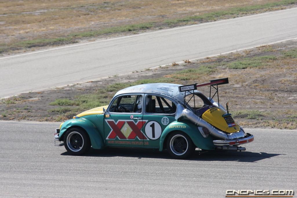

I have a VW Bug race car with a type four motor.
I would like it to safely rev up to 6500-7000 rpms.
What is needed to accomplish this?
thanks

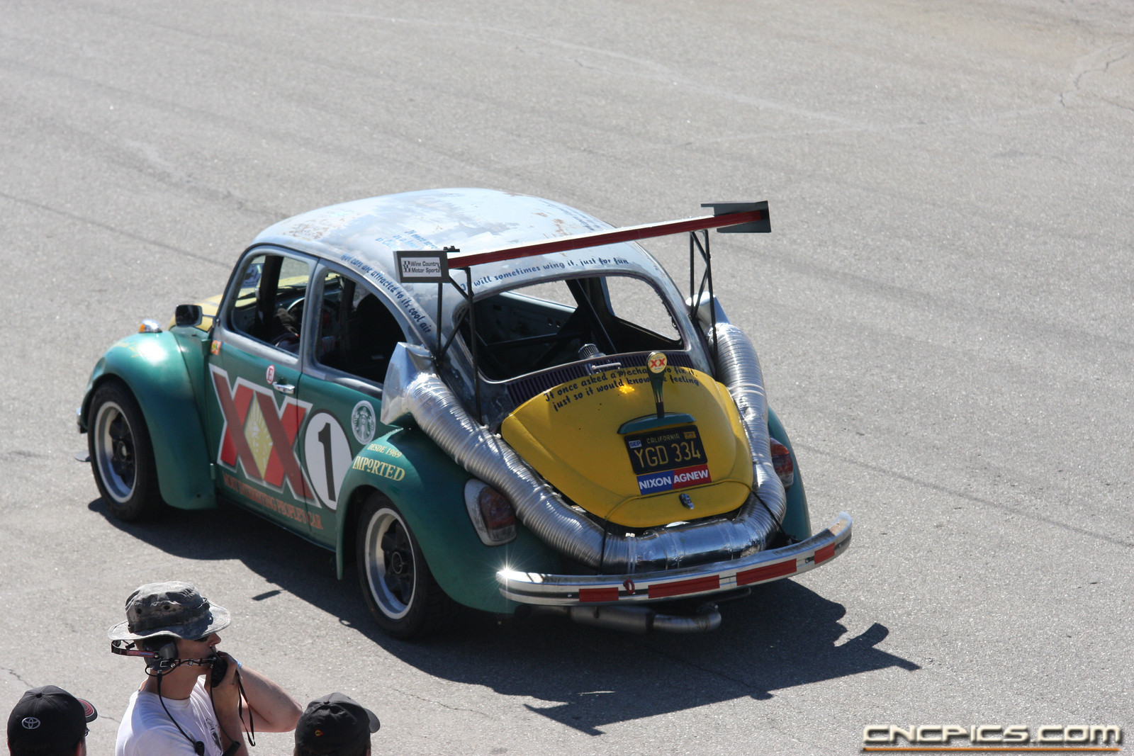

We missed our class win by two laps.
We were doing 70-100 on the fast sections.
Just limited to low rpm's in the first race.
We modified the valve covers and added better crankcase venting so we are getting there.
This last race, we were in 4th overall after 4 hours before we retired due to the split on engine oil cooler.
Here's a couple shots of the cooling ducts.
All parts were found at, surprise, Home Depot!
The air was directed from both sides and into a tee, that pointed right into the impeller on the motor.
