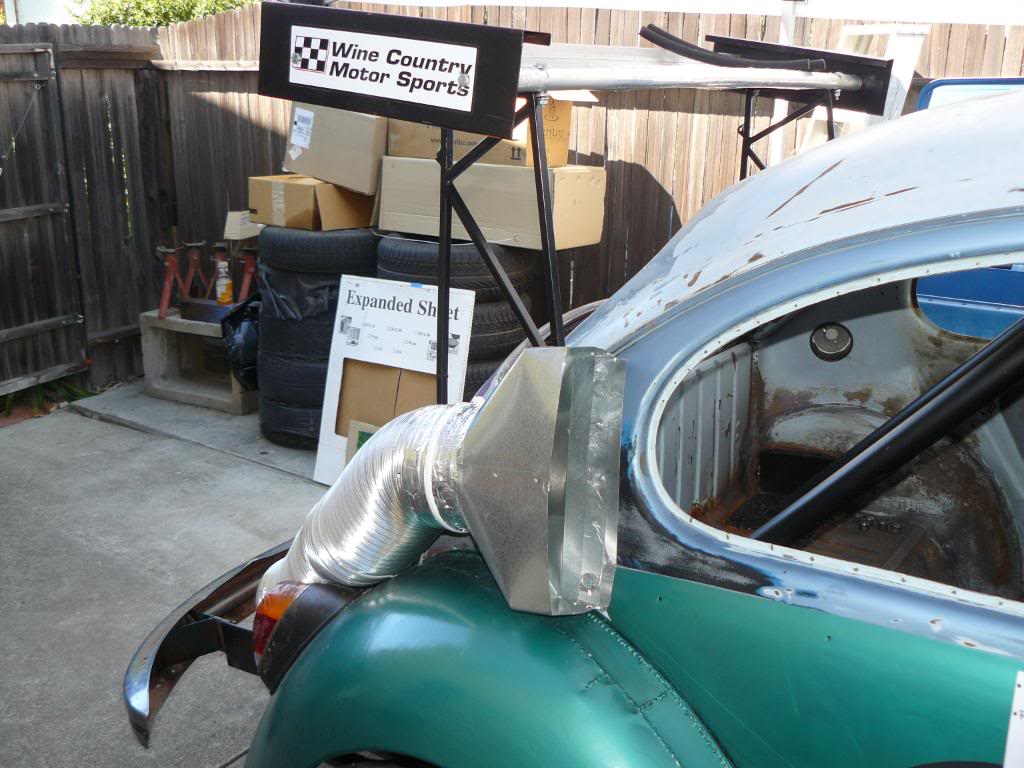

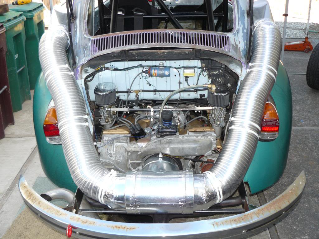

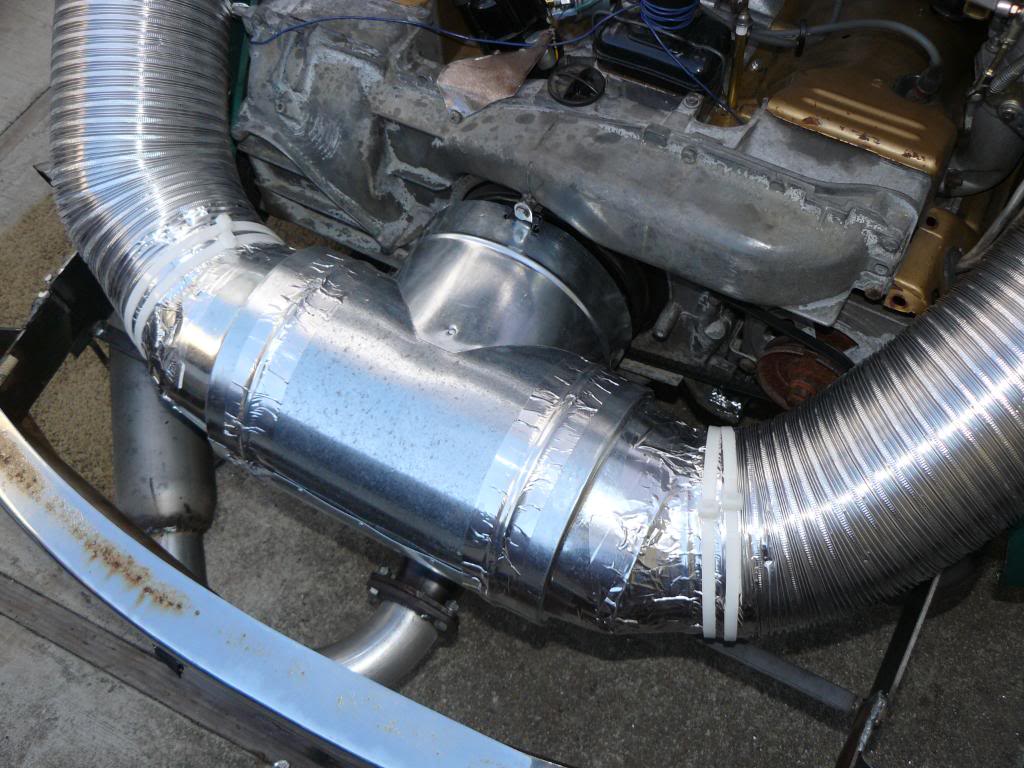

better view of the duct work!:
(IMG:http://www.914world.com/bbs2/uploads_offsite/i944.photobucket.com-1413-1371235043.1.jpg)
(IMG:http://www.914world.com/bbs2/uploads_offsite/i944.photobucket.com-1413-1371235044.2.jpg)
(IMG:http://www.914world.com/bbs2/uploads_offsite/i944.photobucket.com-1413-1371235044.3.jpg)

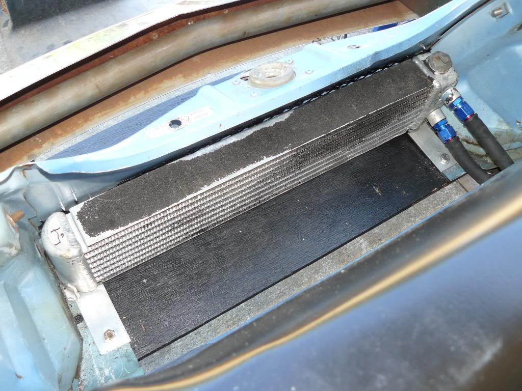

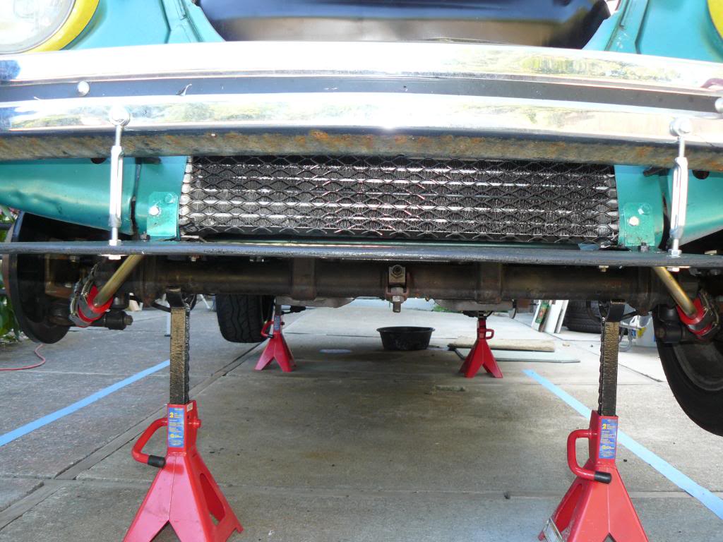

Plus we have a thermostat controlled, front mounted oil cooler:
(IMG:http://www.914world.com/bbs2/uploads_offsite/i944.photobucket.com-1413-1371235044.4.jpg)
(IMG:http://www.914world.com/bbs2/uploads_offsite/i944.photobucket.com-1413-1371235044.5.jpg)
