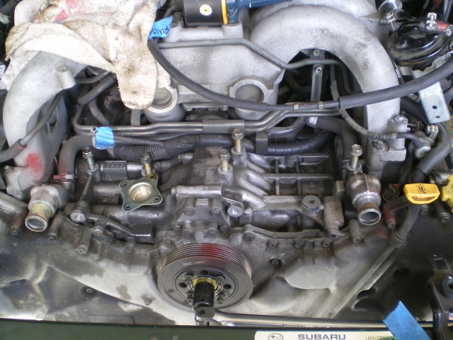

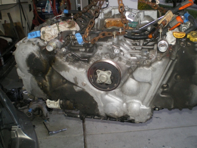

Between a very busy work schedule and the NBA Finals, I finally got this sucker pulled. There has been a lot of work going on but nothing to post that would reflect that. (IMG:style_emoticons/default/sad.gif)
Thanks to Ethan and his Dad, Paul for the loan of the cherry picker. Next up is re- sealing this engine where it has a few small oil leaks, then on to the actual fitment. The leaks seem to be on the lower corners of the heads. Those corner bolts were loose, also. (IMG:style_emoticons/default/WTF.gif) The timing chain cover appears to have a small leak, too.
I used My "Andy Lens" for this shot. (IMG:style_emoticons/default/dry.gif)

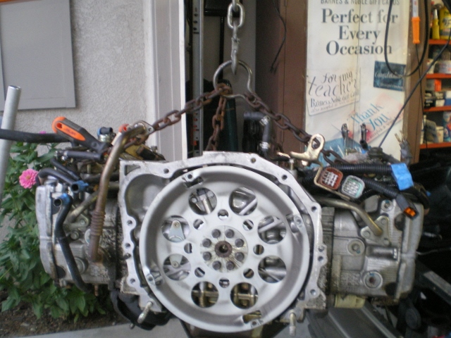

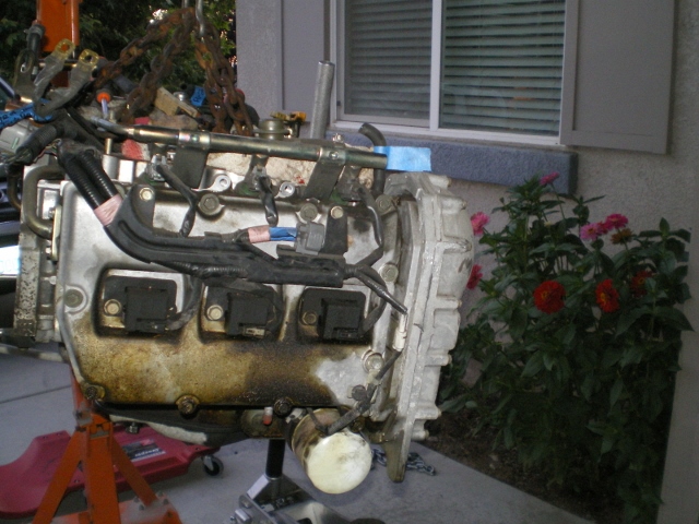

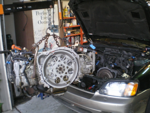

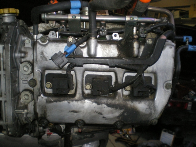

76-914   Some very good points, DB. I had already formulate...   Jun 15 2013, 08:57 AM

76-914   Needed something to do but I have the engine clean...   Jun 27 2013, 07:03 PM
