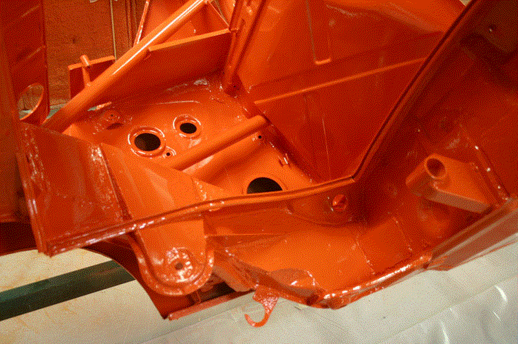

I believe many conversions V8's, got in trouble when they removed the engine shelve from the compartment. While it makes for a clean look you can see from this recent photo that it does reinforce the top of the suspension ear. I saw a car on Patrick motorsports site where they added a triangle from the ear to the long to add stiffness.
(IMG:http://www.914world.com/bbs2/uploads_offsite/img.photobucket.com-12969-1371155019.6.jpg)
Heres the pic from patricks site, notice the ear reinforced then a simple triangle added for strength under the engine shelf. Tough to do with the stock engine mount in place but not impossible. Also the top of the Ear boxed for more strength. Nothing new for the Racer types on the forum. And per JP's thread- seam weld everything.
(IMG:http://www.914world.com/bbs2/uploads_offsite/patrickms.s3.amazonaws.com-13632-1367063226.1.gif)
