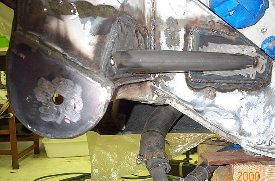

carr914   Here's how Rich Johnson Strengthed my car   Jun 16 2013, 07:41 AM
