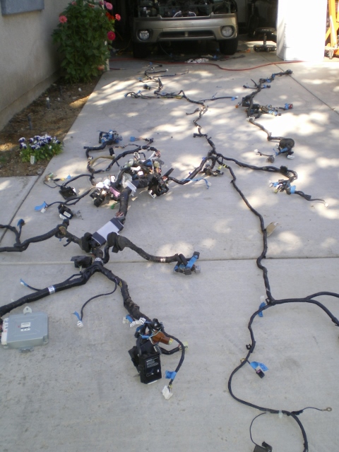

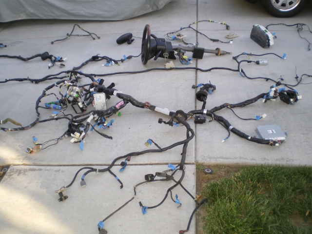

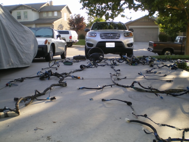

Well I finally got the last wiring harness out. If and when I get this sorted out (thought I'd give myself some breathing room in case this is over my head (IMG:style_emoticons/default/dry.gif) ) I expect the harness should be about the same size as the teeners. Notice the rear view mirror in the pic. It has an auto dimming feature which should be the Cats Ass in a teener. It was a Royal PITA to remove it w/o cutting it. Hope it pays off. (IMG:style_emoticons/default/sad.gif) When taking this pic today I was once again questioning my sanity. Is this project bigger than me? What was I thinking? Then I tell myself to compartmentalize things and take a deep breath. (IMG:style_emoticons/default/dry.gif) Anyway, the cannibalization of the donor is over and it's time to see what fits.

76-914   Well I finally got the last wiring harness out. If...   Jun 17 2013, 08:48 AM
bulitt   Dear God.   Jun 17 2013, 09:07 AM
Chris H.   Kent, I know that feeling but you are doing great....   Jun 17 2013, 09:18 AM
ruby914   Piece of cake. :D Learn how to open the connector...   Jun 17 2013, 07:56 PM
76-914   Thanks guys, good info. And I hope that I pulled o...   Jun 17 2013, 09:35 PM
DBCooper   What I thought was an intelligent way of organizin...   Jun 18 2013, 05:48 AM
76-914   That's pretty much what I have planned except ...   Jun 18 2013, 09:00 PM
