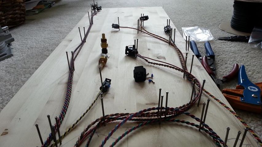

What I thought was an intelligent way of organizing things:
(IMG:http://www.914world.com/bbs2/uploads_offsite/sphotos-b.xx.fbcdn.net-2618-1371556112.1.jpg)
He does it regularly, of course, so it's kind of a production tool, but it still made sense to me as a way of keeping things sorted.

76-914   Chris, I'd have to agree with you on the wirin...   Jun 3 2013, 03:09 PM
DBCooper   You guys who re-purpose the wiring harness and all...   Jun 3 2013, 04:00 PM
Chris H.   You're doing great Kent! I failed to mark...   Jun 3 2013, 04:16 PM

DBCooper   If you bought an aftermarket ECU from a company li...   Jun 4 2013, 06:54 AM
76-914   Some very good points, DB. I had already formulate...   Jun 15 2013, 08:57 AM

76-914   Well I finally got the last wiring harness out. If...   Jun 17 2013, 08:48 AM
bulitt   Dear God.   Jun 17 2013, 09:07 AM
Chris H.   Kent, I know that feeling but you are doing great....   Jun 17 2013, 09:18 AM
ruby914   Piece of cake. :D Learn how to open the connector...   Jun 17 2013, 07:56 PM
76-914   Thanks guys, good info. And I hope that I pulled o...   Jun 17 2013, 09:35 PM
DBCooper   What I thought was an intelligent way of organizin...   Jun 18 2013, 05:48 AM
76-914   That's pretty much what I have planned except ...   Jun 18 2013, 09:00 PM
