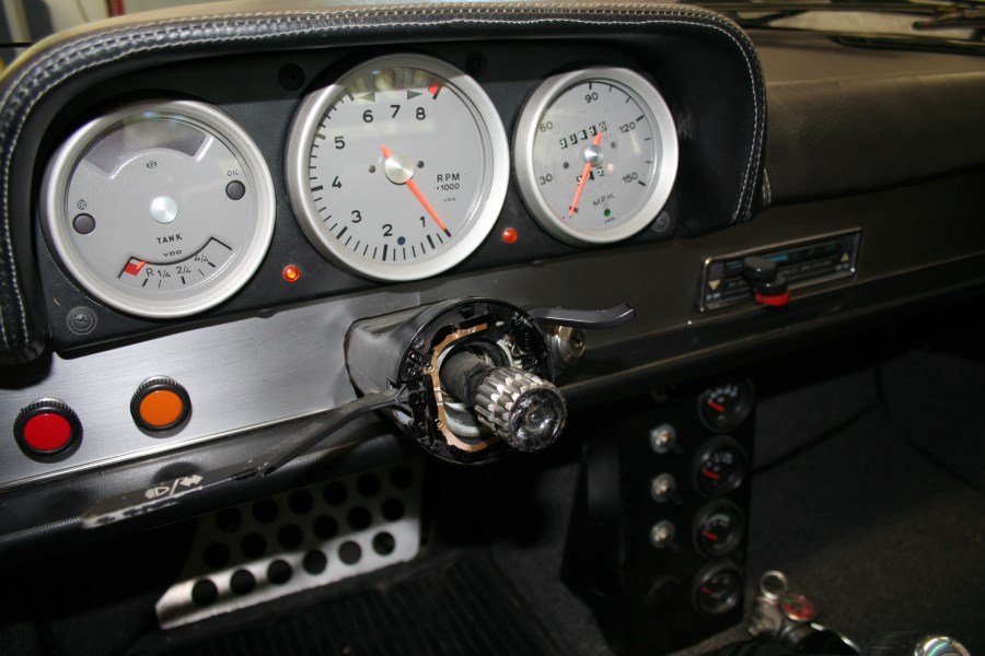

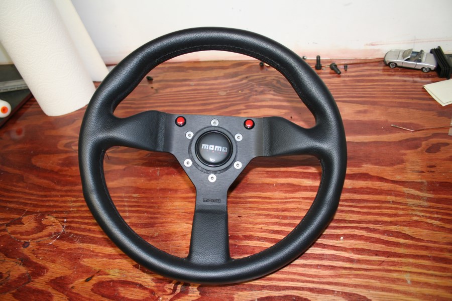

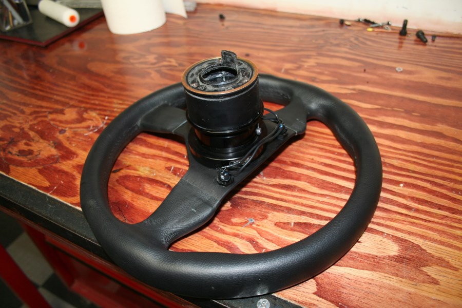

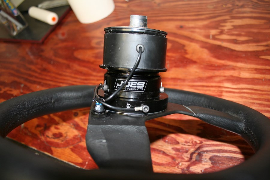

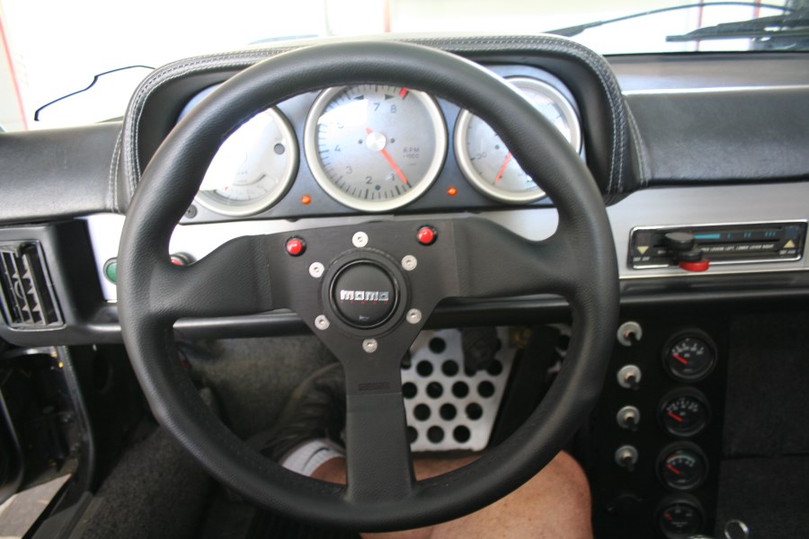

I went a little cheaper and bought mine from "Joes Racing". I had to weld the new spline over the old one. I also wanted a horn button and more importantly auto turn signal canceling. (I got tired of being the old bastid driving down the highway with his left turn signal going for miles). (IMG:style_emoticons/default/lol-2.gif) I had to get a little creative and use a piece of two inch plastic pipe to mount the turn signal canceling tab. The horn buttons work but I haven't driven the car with this installed yet to see if the turn signal cancel works.
Cheers, Elliot
