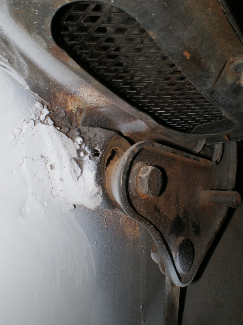

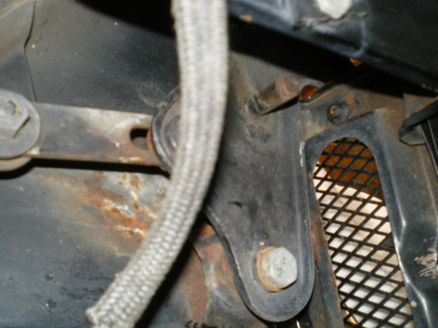

Needed something to do but I have the engine cleaned up and awaiting some seals. Then Aircraft Spruce sold me the wrong size 4130 tube so I can't start making motor mounts. (Notice how I blamed ACS. That felt good. Kinda relieves one of that nagging feeling brought on by accountability.) Herschel came by and picked up the Subaru skeleton today so that's done. Then I remembered the shock kit that Elyut sold me. Smoking deal, thx.
Left rear
right rear
left front
right front
I've always had a clunk as the rear lid was raised and lowered but basically ignored it. After I removed the old torsion bars and rollers I was able to see this. And before you say anything those are not my welds. Mine aren't nearly that good. I knew this area needed to be cleaned up but hadn't expected this. What is supposed to be there? A bearing? A bolt? A nut? I'll find out when I pull it apart I guess.
The right side is gut sans the welds again. These welds look like someone tried to stick weld them on. Surely not factory. I have this side to reference if I don't get an answer.

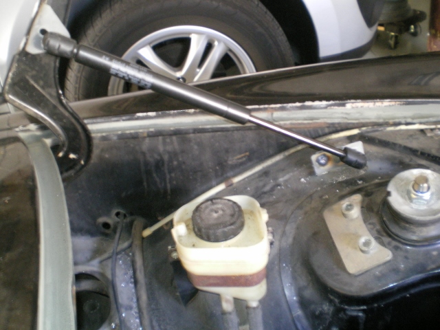

76-914   I received the trunk hinge from Restoration Design...   Jul 11 2013, 10:22 AM
