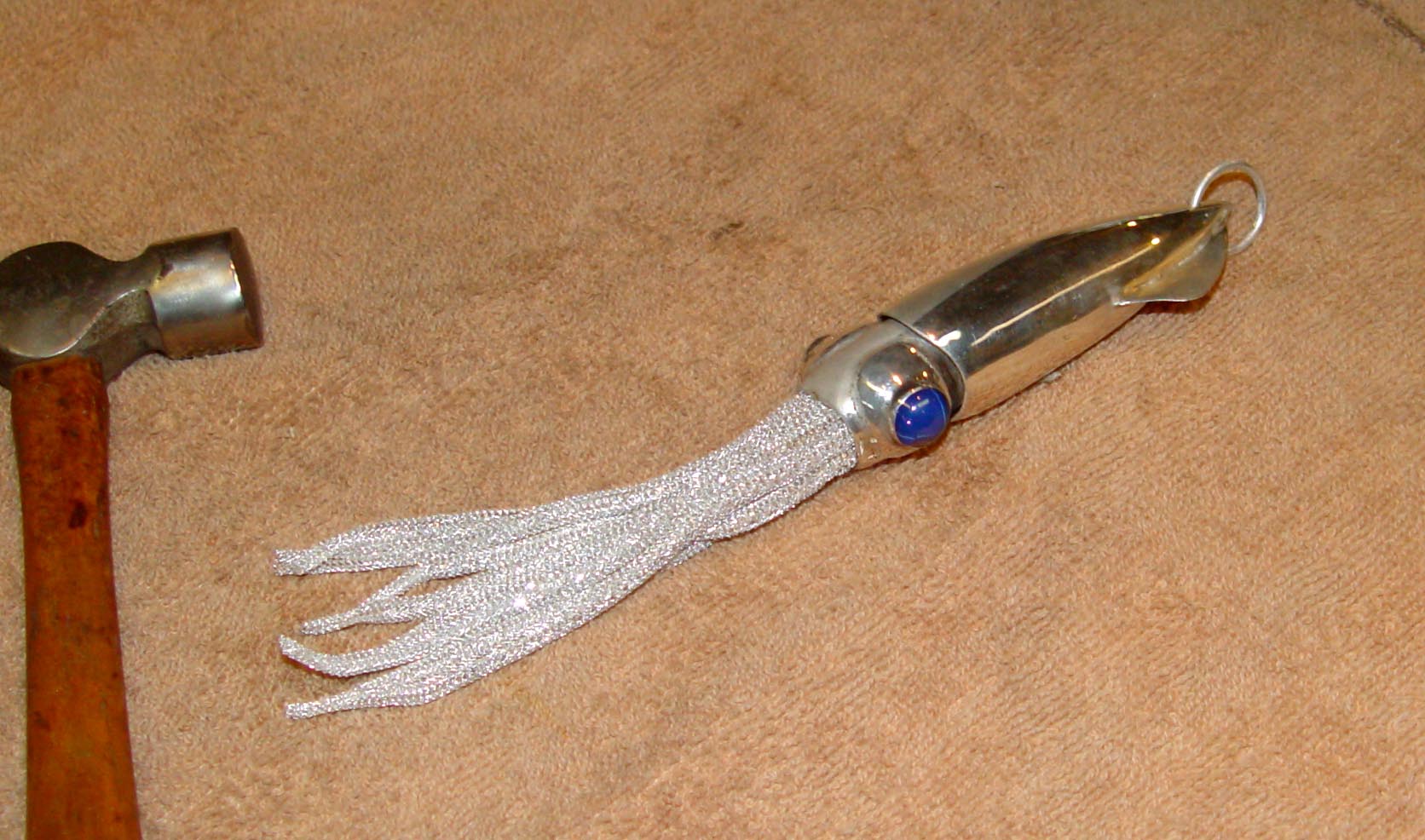

Well Stu, that works for tool steel. If you work with silver or copper, it is the opposite. If you want to harden these metals as they sometimes do with gold in dentistry, a slow cool will harden. If you want to make something in silver or gold and bend it as I sometimes do for my wife, then you anneal by heating to a dull red and flash cooling in water. You get dead soft material that stays that way till it is work hardened and you do it again to keep it from cracking as you go.
It started as a square of silver that set my credit card back (less than 914 parts)
"Ah, Squiddy, I'd nothing against ye, Its just that I heard there was gold in yer belly" -The Capn.
