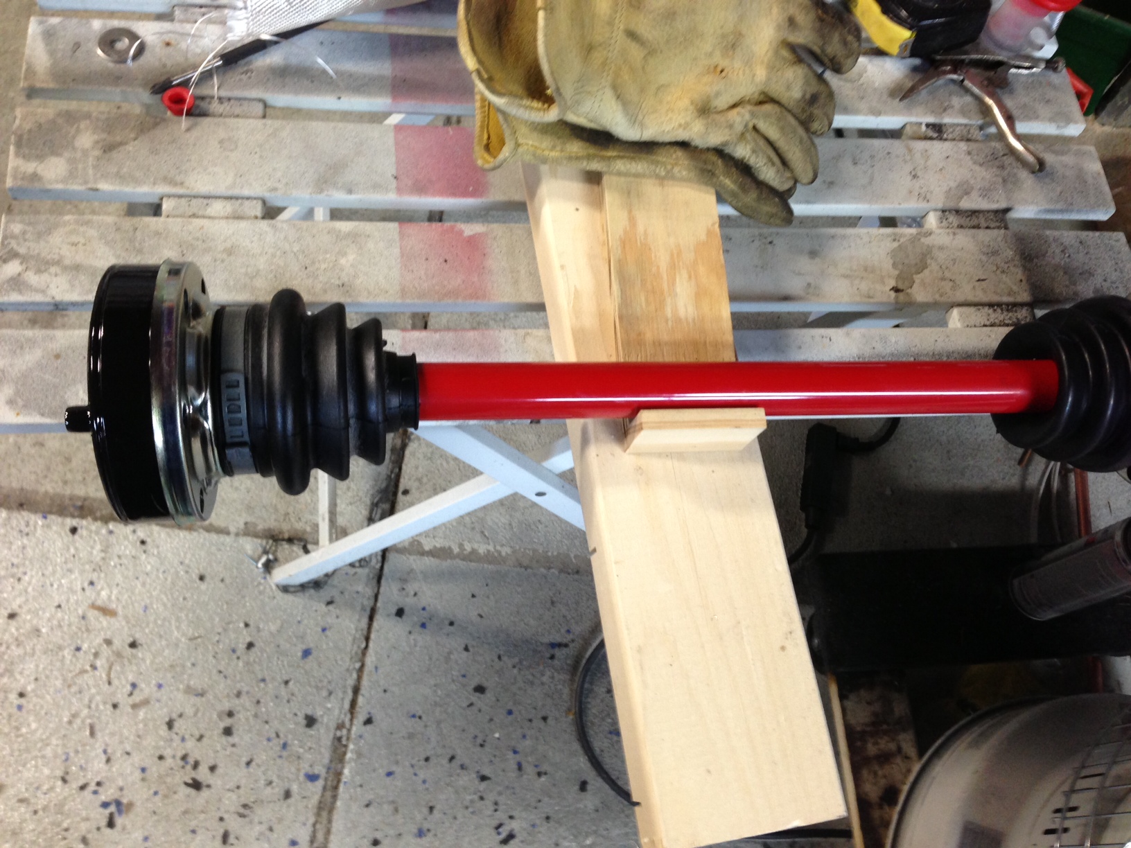

Behold my new 914 axles with 911 C/V joints and sway-away axles. However where can I find new boot clips? The originals have 74 oetiker stamped on them.
For those of you considering this route the C/V joints are pressed on the the axles and It took 500 psi with a press to separate them. Thanks for your help Eric.

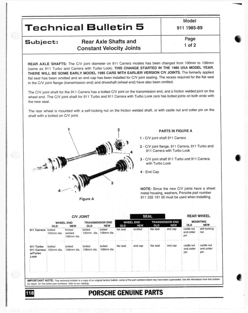

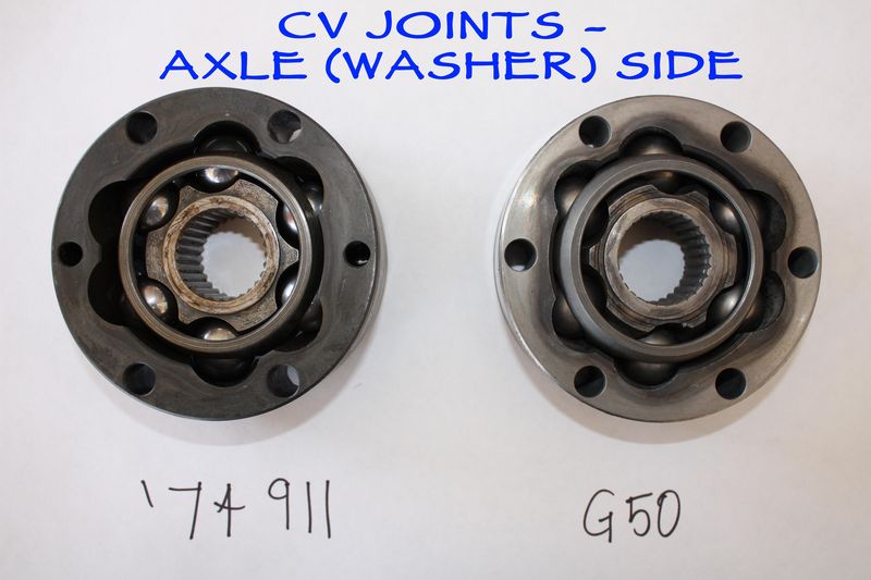

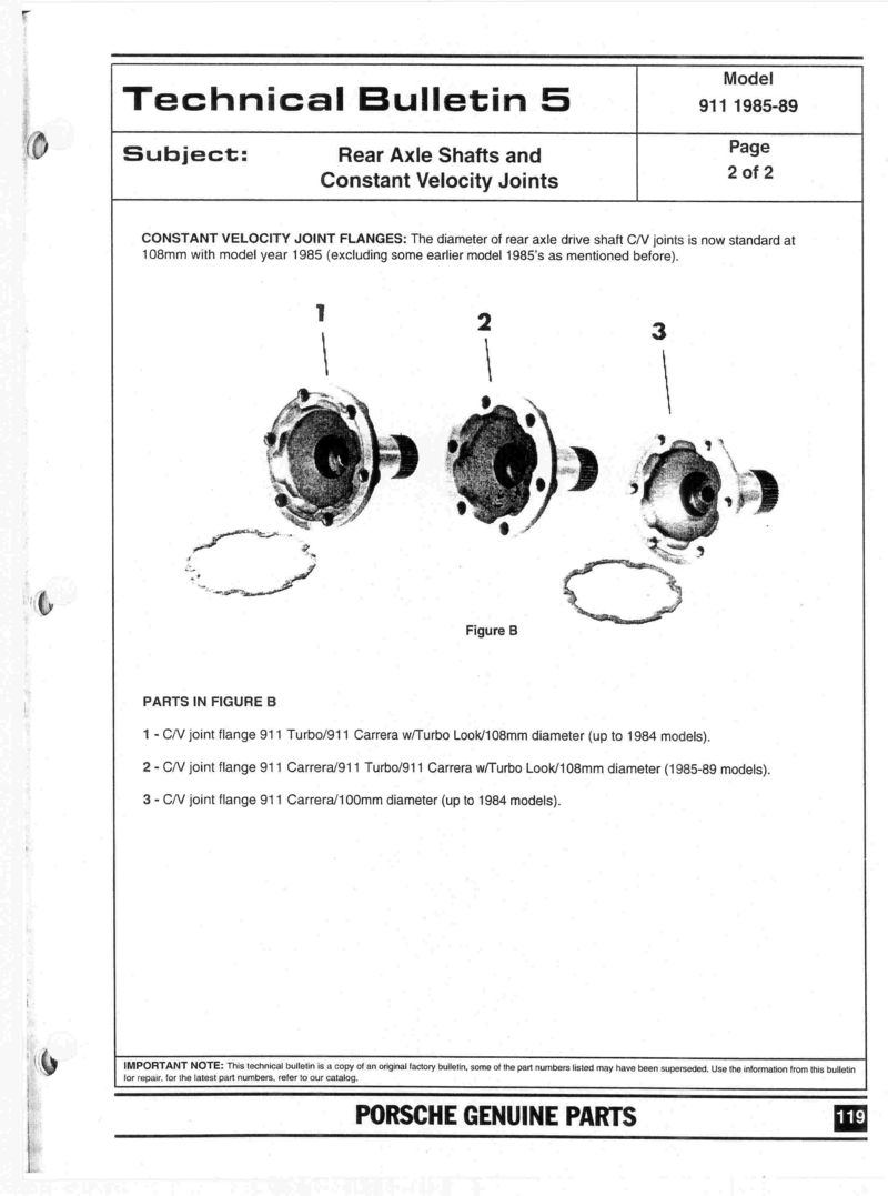

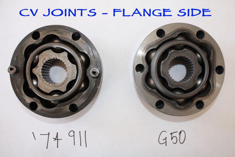

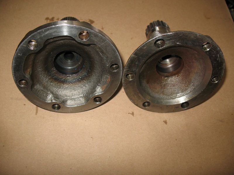

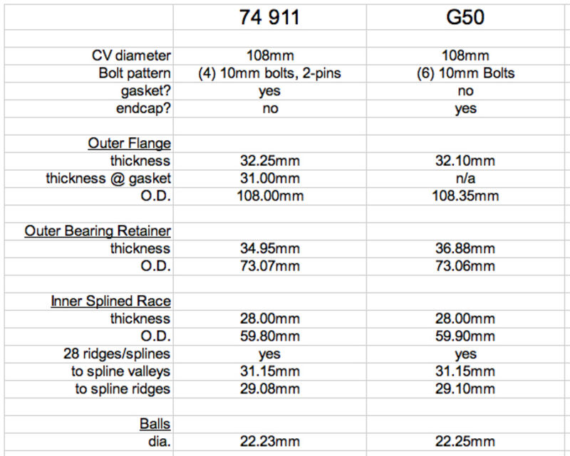

I was going this route, but I'm thinking of using the later G50 CV, mainly because I'm a CSOB (would save me $150) and I should be able to figure out a solution for the gasket/end cap issue.
The G50 is 6 bolt X 10mm and has no relief for a gasket, but is suppose to be the same in all other regards.
http://forums.pelicanparts.com/porsche-911...patibility.html
Part number for the G50 CV is 911-332-923-01-M60
http://www.pelicanparts.com/cgi-bin/ksearc...-332-923-01-M60
(IMG:http://www.914world.com/bbs2/uploads_offsite/forums.pelicanparts.com-26-1372786441.1.jpg)
(IMG:http://www.914world.com/bbs2/uploads_offsite/forums.pelicanparts.com-26-1372786892.1.jpg)
(IMG:http://www.914world.com/bbs2/uploads_offsite/forums.pelicanparts.com-26-1372786892.2.jpg)
Only real issues is the 6 bolt 10mm vs 4 bolt 2 pin and no gasket. It looks like the 928 cap will not fit into the early flange/stub.
(IMG:http://www.914world.com/bbs2/uploads_offsite/forums.pelicanparts.com-26-1372786893.3.jpg)

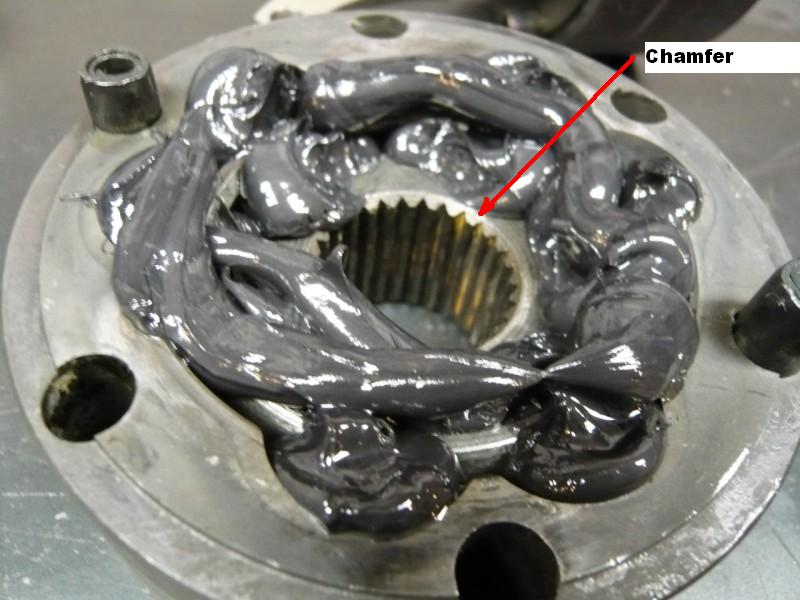

kconway   Eric, I'm wondering about the orientation of t...   Jan 22 2009, 10:00 PM
Gint   Eric, I'm wondering about the orientation of t...   Jan 22 2009, 10:09 PM
Gint   While I'm here, no groove for a retaining ring...   Jan 22 2009, 10:16 PM

tomeric914   Adding to an already great thread... Dimensions o...   Aug 21 2013, 08:52 PM
PRS914-6   Adding to an already great thread... Dimensions ...   Aug 22 2013, 09:27 PM
Harpo   Adding to an already great thread... Dimensions ...   Sep 29 2013, 02:53 PM

Mark Henry   Ok some pics on thisfirst it's not just a ...   Jan 19 2014, 11:25 PM
Mark Henry   Difference in shaft lengths between the 1970 901 f...   Jan 19 2014, 11:27 PM
Mark Henry   This is the 1970 911/901 flange sitting in a 914-9...   Jan 19 2014, 11:31 PM
Mark Henry   This is the "sporto" (1969 901) flange s...   Jan 19 2014, 11:35 PM
Mark Henry   Oh.... and a bit of axle porn. :D Fully loaded a...   Jan 19 2014, 11:45 PM
Mark Henry   One question I have and I guess I should email Swa...   Jan 20 2014, 07:59 AM
Mark Henry   Yes the Swayaway axles are directional. Got an rep...   Jan 20 2014, 01:17 PM
