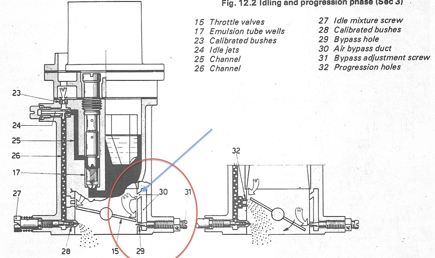

Sorry you're the one that's backwards. All air coming into the engine flows through the ventri, so no matter if the throttle plate is opening, or the air-bypass screw is backing out, that air is flowing through the snail and reading higher.
BY-PASSING, the throttle plates and reducing the flow thru the venturi.
NOPE! It's does bypass the throttle plate, but it's still flowing through the venturi. Air entering the 'bypass chamber' comes from the main airflow. There isn't a separate air inlet for the bypass. With regards to airflow, backing out the bypass screw is essentially the same as opening the throttle plate.

rhodyguy   for heavens sake. how in the hell, with all 4 by-p...   Jul 3 2013, 08:11 AM
McMark   Sorry you're the one that's backwards. Al...   Jul 3 2013, 11:32 AM
